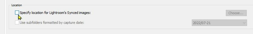

"Importing" should not be necessary!
If your images are synced (as suggested by Ranjisha) then you only need to enable 'Sync' in Lightroom-Classic and all Cloud images will download to Lightroom-Classic automatically.
It is suggested that you first decide the Folder location for the downloaded photos in LrC Preferences > Lightroom Sync...
SYNC SETUP IN CLASSIC
Regards. My System: Windows-11, Lightroom-Classic 15.3, Photoshop 27.5, ACR 18.3, Lightroom 9.3, Lr-iOS 10.4.0, Bridge 16.0.3 .
