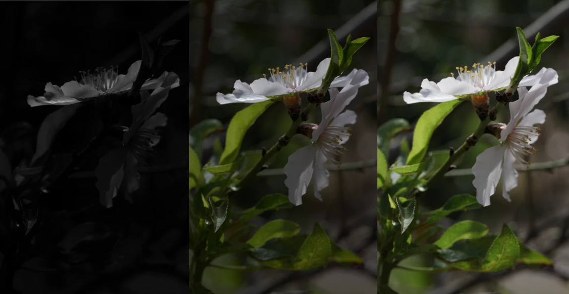

If you know what a Raw file is, you will understand that this is impossible. A Raw is data file containing a digital representation of the analog output from the camera's sensor (voltages caused by incoming light intensities). It contains a single channel, a number for each pixel, and therefore an image built directly from Raw data would be only tones of grey. The color image with three channels per pixel is created by the Raw converter, either the one in your camera or Lightroom, through a process called "Demosaicing". The Raw image would also be dark and flat because the data is linear. Another part of the processing for color involves the application of a correction curve that makes it brighter and contrastier. So some processing has to be done by every Raw converter to every Raw file even to get to the "minimum". Even when the sliders are at zero LR's processing is fairly strong, because "zero" does not mean "none". Michael Frye, in his book "Landscapes in Lightroom", says that since the introduction of Process Version 3 in 2012, minimal processing would be Exposure -1.0 and Contrast -33. An additional factor is that Lightroom does another automatic correction to Raw images that is based on the camera model and the shooting ISO, called the Baseline Exposure. For instance, for my Canon 80D the BLE is ISO 100 - 0, ISO 200 - +0.28 and ISO 400 and up - +0.32.
In the photos below, on the left is the Raw image as seen in Raw Digger; the middle is a minimally processed RGB rendering by Raw Digger; and on the right is Lightroom with all sliders zeroed.

Thanks for the technical info. What I understand now is that there is no such thing as the "real original photo", even when shot in RAW. It's not like a slide was. A RAW has to be interpreted - Demosaiced - to become an actual image. But after all, every screen is already an interpretation so what matters, from my point of view, is to get the most faithful image to the souvenir we keep of what we saw when we shot it.
