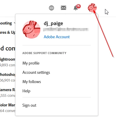

Once you import the photo(s), you should be in the Lightroom Library module, and the most recently import photo(s) should be displayed. Select a photo, press D (or click on Develop) and edit the photo. If you want to come back later and edit the photo(s), go to the Library Module and find the photo(s) and edit them, no importing needed.
Your previous threads can be found by clicking on your name at the top of this thread, or from the main LrC forum page, click on your avatar icon and select My Profile.

I found my questions and your answers under my profile and avatar (do now know what that is) Thanks for that.
