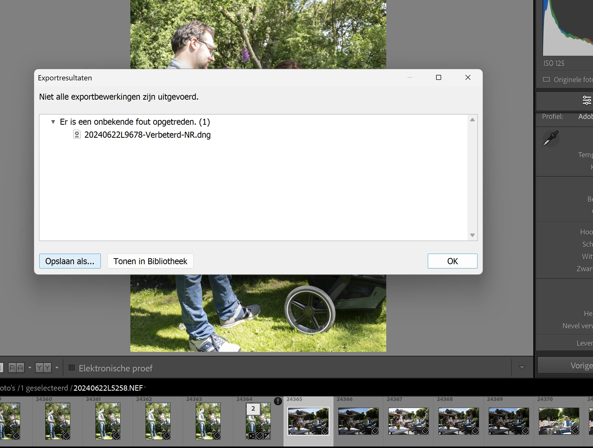

I had problems in 13.3.1. for 2 day's . Problems specialy writing Files. Also when creating DNG file in noise reduction. My mouse was sluggy. I removed Lightroom classic from my computer and reinstalled 13.3 .
Till now : no problems.

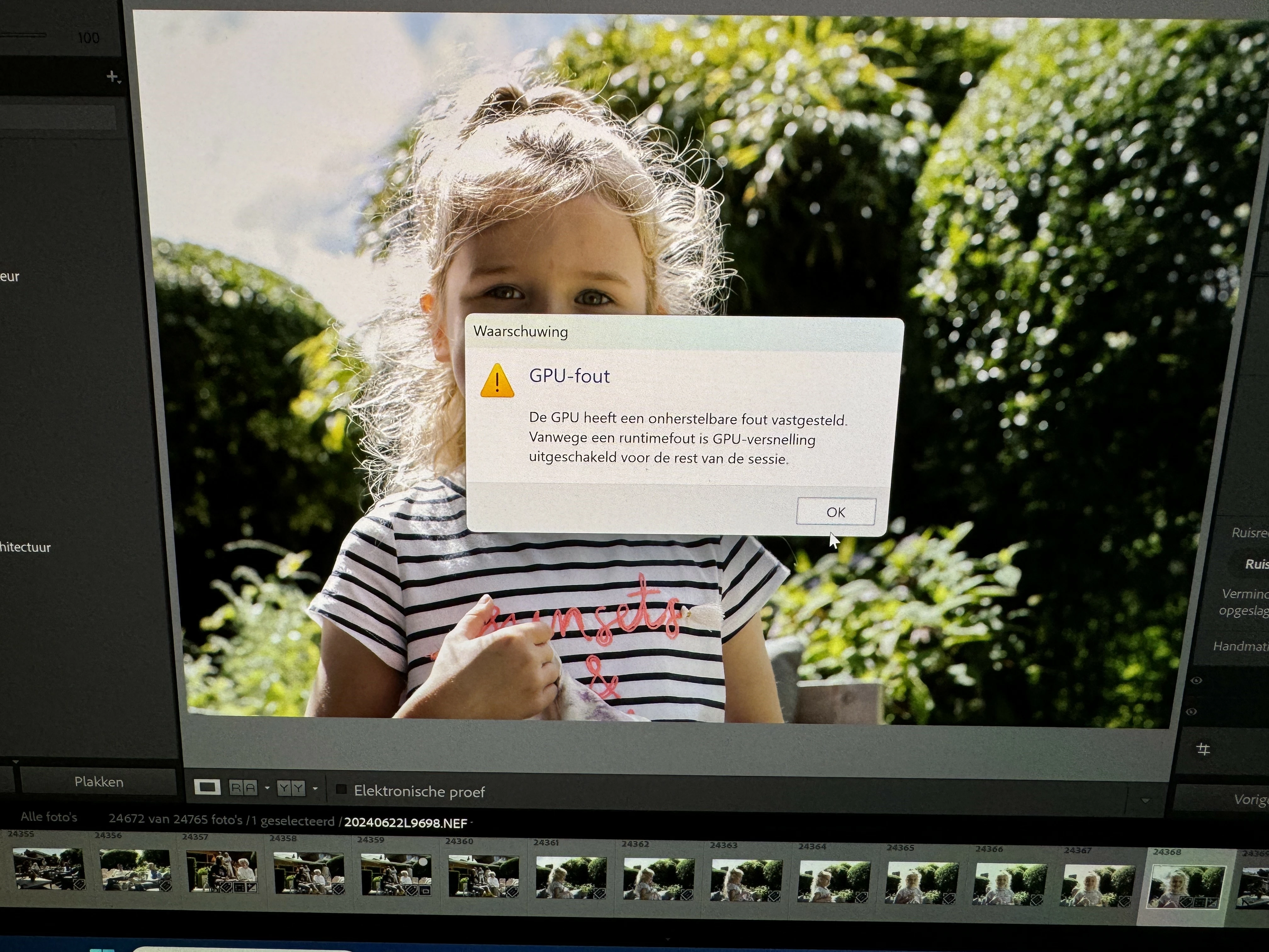

GPU-fout
De GPU heeft een onherstelbare fout vastgesteld.
Vanwege een runtimefout is GPU-versnelling uitgeschakeld voor de rest van de sessie
GPU error
The GPU has encountered an unrecoverable error.
Due to a runtime error, GPU acceleration is disabled for the remainder of the session
and
Niet alle exportbewerkingen zijn uitgevoerd.
Not all export operations were completed
So, the first error message, Indicating something is wrong in LrC use of your GPU.
First up, as you have a Windows computer, and you have an odd issue that may relate to a bit of hardware or hardware driver. Have you tried restarting your computer. Not a shutdown, but a restart. This should clear any odd thing in memory or CACHE that Windows may have issue with.

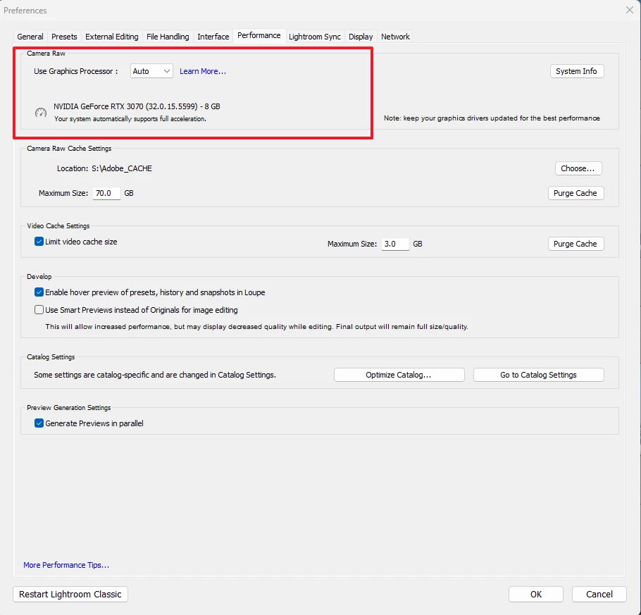

Second up, what GPU make/model, and what GPU driver do you have? Perhaps you can share a screenshot of LrC /Preferences/Performance.
example:
