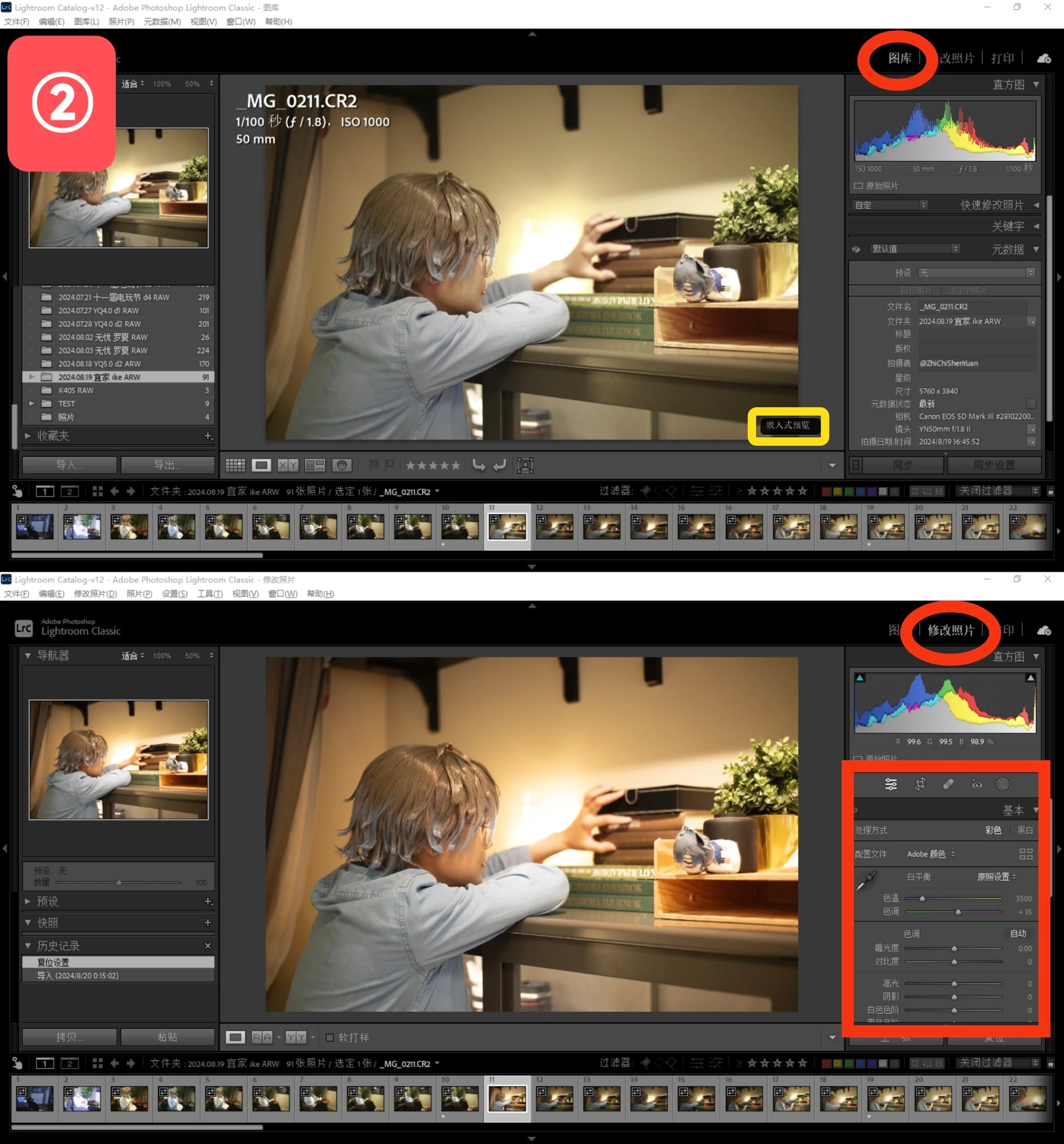

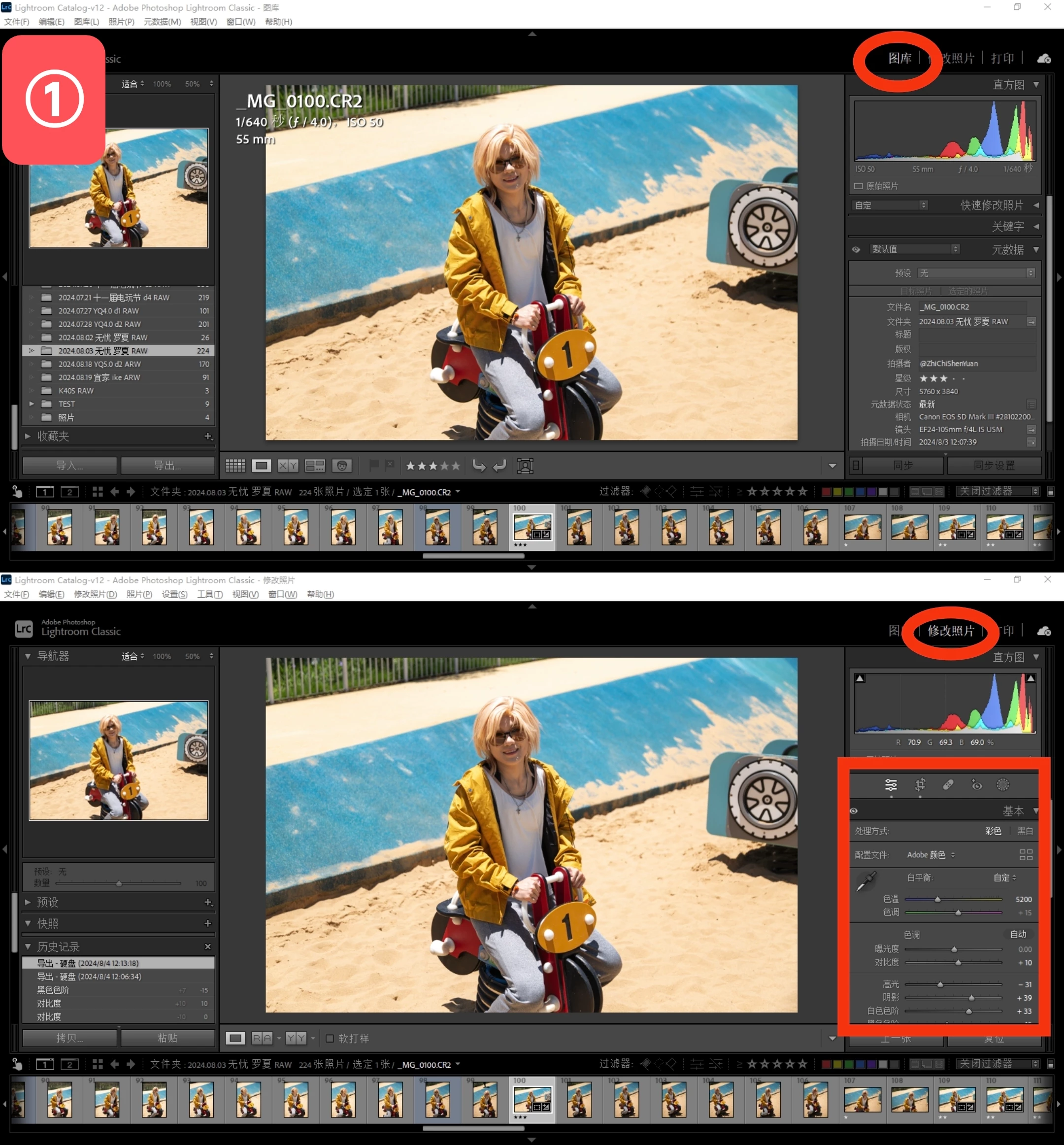

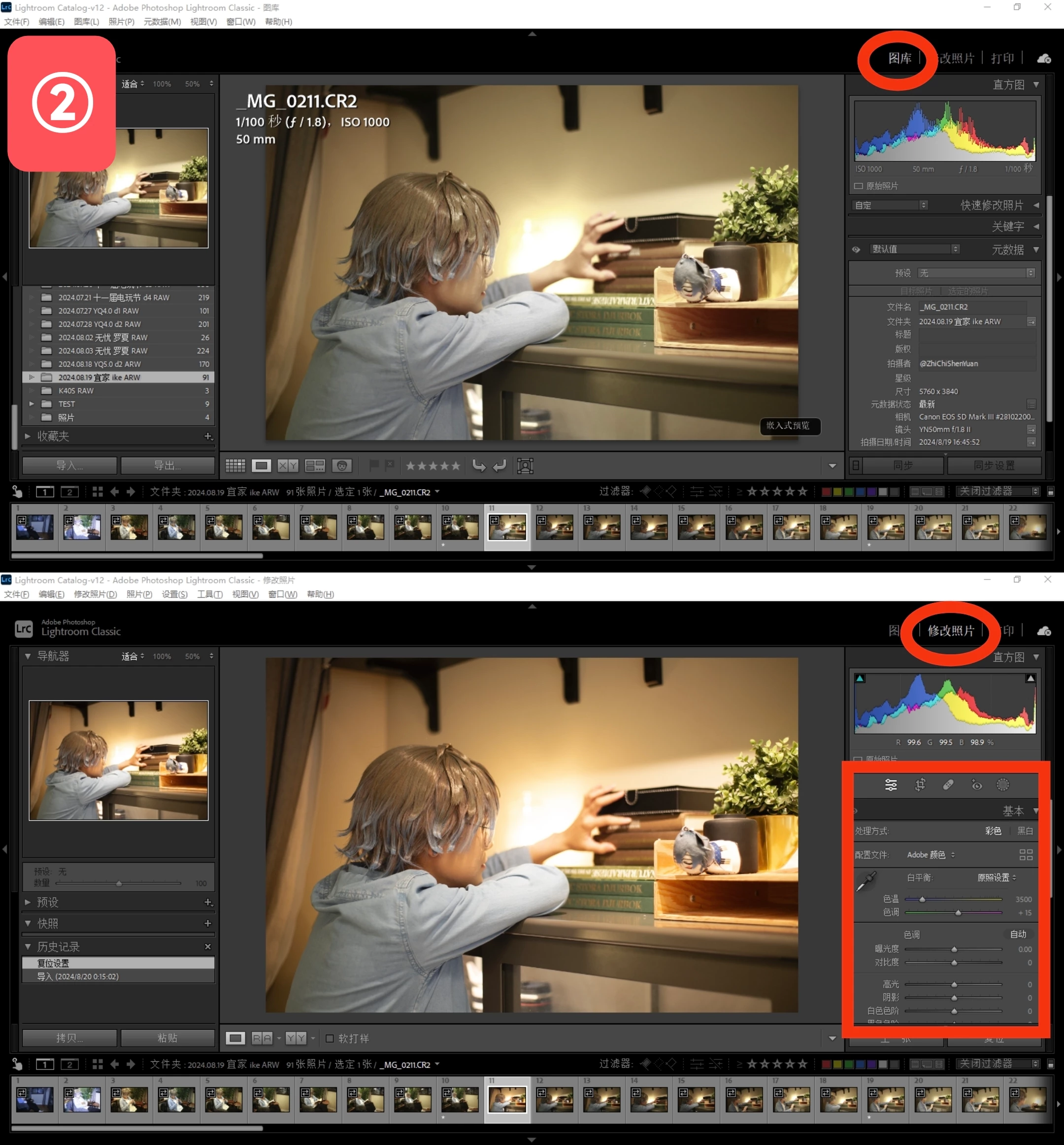

Inconsistency in color, contrast, etc. of the images displayed by LrC Library and Develop.
LrC Library 和 Develop 中显示的图像在颜色、对比度等方面不一致
重新安装 Win10 并更新使用 Lightroom Classic 后,我发现将图像导入 lrc 后,库中显示的图像与修改后的照片中显示的图像不匹配。
我从帮助中了解到“库模块和第二个窗口使用与修改照片模块不同的颜色空间和渲染图像预览的方法。
但是,在查看升级后的系统和软件之前导入的图像显示相同,这与Adobe帮助中描述的不同,您能否请帮我解决这个问题?
(1)升级前进口。显示一致且正常。
(2)升级换代后进口。显示不一致。

The images displayed in the LrC Library and Develop are inconsistent in terms of color, contrast, etc
After reinstalling Win10 and updating to use Lightroom Classic, I found that after importing the images into lrc, the images displayed in the library did not match the images shown in the modified photos.
I learned from the help that the "Library module and the second window use a different color space than the Develop module and a way to render image previews."
However, the images imported before viewing the upgraded system and software show the same, which is different from what is described in Adobe Help, can you please help me with this?
(1) Imported before upgrading. The display is consistent and normal.
(2) Imported after upgrading. The display is inconsistent.
By @zhichi shenyuan
I strongly suspect that this means Embedded preview.
You have set LrC to use the jpg previews embedded in the raw files, rather than having LrC create its own Library previews.
You control this in the import dialog, where you seem to have chosen Embedded & Sidecar under File Handling > Build Previews. Use a different option (like Standard), and the embedded previews will not be used, and Library and Develop should display identically.
Library and Develop do use different color spaces for previews, but color management makes sure that they display identically, except in rare cases, depending on the color gamut of your monitor.
