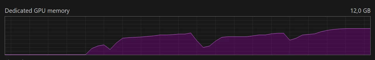

Again, the limiting factor may well be something other then the E-cores, such as:
- Effective memory bandwidth between CPU and GPU. If the raw pixels can't be transferred into and out of the GPU fast enough, then the GPU can't be fully utilized.
- GPU memory. Your screenshot suggests that GPU memory may be a bottleneck at 80% full:
I.e. the CPU could be waiting for GPU memory to become available before transferring the raw pixels to the GPU.  As the CPU starts the transfer, another photo completes, freeing up some GPU memory, which would account for why utilization is 80% and not 100%.
- Disk bandwidth. If your 40 MP raws are about 50 MB each and the generated JPEGs about 10 MB each, then even an older external spinning drive should be able to read 50 MB/sec and write 10 MB/sec, but it's conceivable that your system couldn't do much faster (especially if you're using a NAS).  If the photos are being read and written from an SSD, then disk bandwidth is not likely an issue.
Any of these possible limiting factors would be consistent with the observed 30% peak GPU utilization. I think one or more of these are just as likely to be the limiting factor as Windows scheduling of E-cores.
