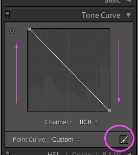

June 26, 2013
You can use the Tone Curve to invert images.
Click the icon to enable Point Curve editing. Drag the corner points to their opposites.
AlaskaAceAuthor
June 26, 2013
Thanks David.
Seems so simple once someone points it out.
Jack
Rikk Flohr: Inactive
June 26, 2013
If you have a lot of these to do you can save that Tone Curve as a Develop Preset. Then it can be applied with a button click. Or to many images at once via the Quick Develop panel.
