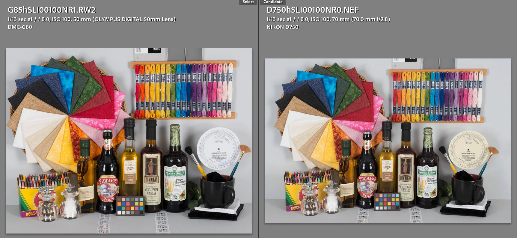

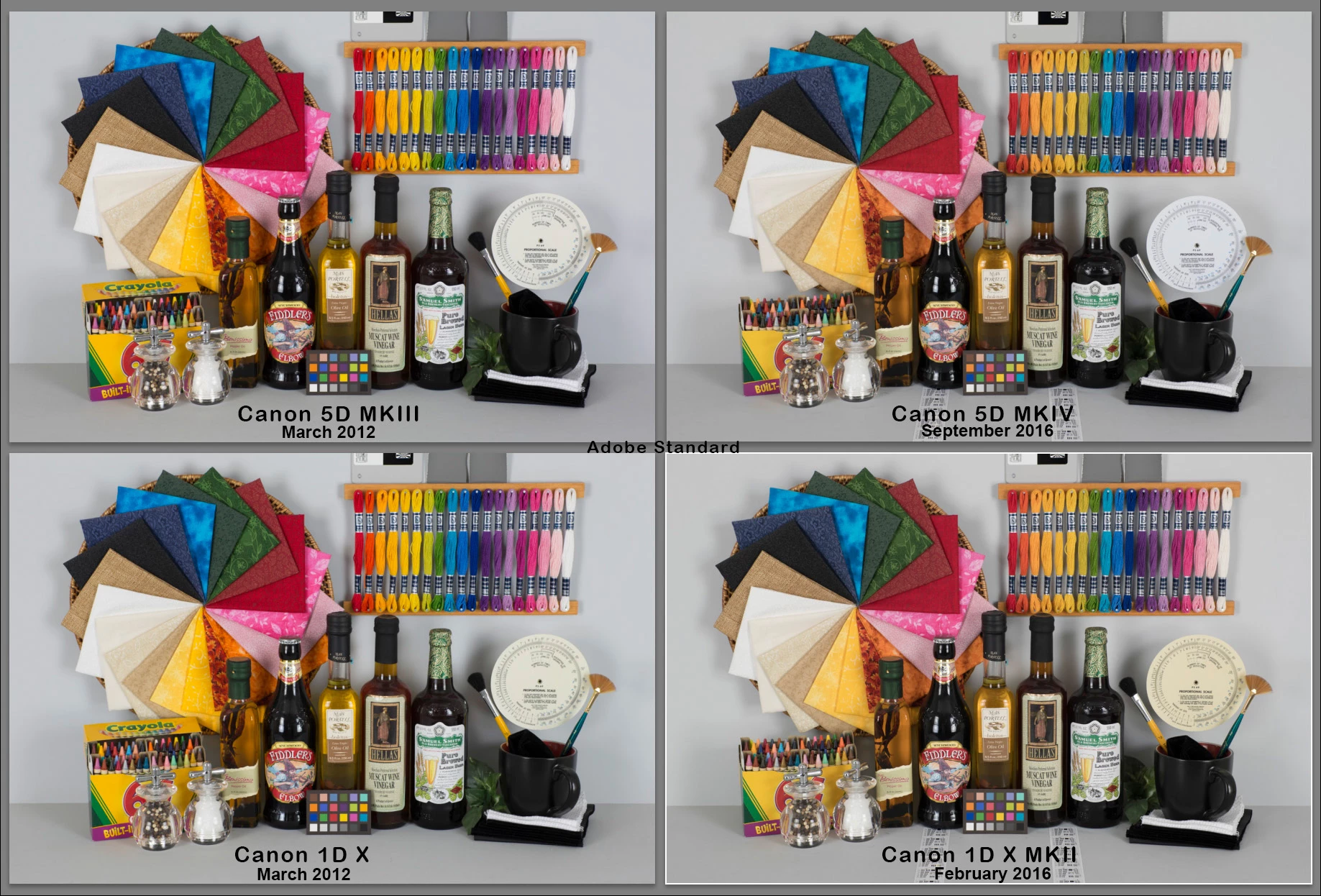

I did further investigation and it appears the Adobe Standard profile metrics have been "silently" changed by Adobe sometime in Q3 2014. All Canon and perhaps all other make camera models introduced since Q3 2014 have Adobe Standard profiles with lower color saturation. In short it looks like Adobe has changed the "standard." It's unlikely they will "fix" these profiles since it appears to have been done on purpose. This means it will be necessary to "adjust" image files shot with new camera models to maintain the same appearance as older models. I couldn't achieve satisfactory results simply cranking up the LR Saturation control or using DPE to modify the profile settings. The best solution is to use a ColorChecker Passport and create new profiles for ALL of your camera models both old and new to match them. There's no guarantee that will be perfect either since the current Adobe profile is used as the "Base Profile" when using the X-Rite plugin or DPE.
I also checked the Nikon D5 and D750 models and they have the same lower color saturation Adobe Standard camera profiles. It appears new Nikon cameras and perhaps ALL manufacturers cameras released since Q3 2014 are affected. Standardized test Raw image files were downloaded from http://www.imaging-resource.com/ under Samples> Thumbnails in each camera review.
Notice the lower color saturation in the Nikon D750 image.

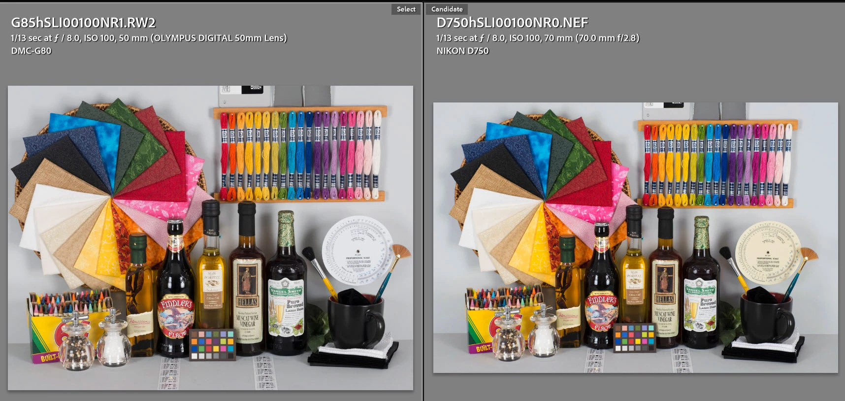

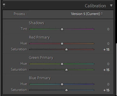

You can use the DNG Profile Editor to create a corrected D750 Adobe Standard or simply use the LrC Calibration panel with the below settings. Using a ColorChecker Passport to create custom camera profiles may also work, but it needs to use a Base Profile such as the exisiting Adobe Standard profile. So they may also be affected with lower color saturation
You can download and install a Nikon D750 corrected Adobe Standard camera profile I created using the DNG Profile Editor at the below Dropbox link. Install it in the below folder location and then restart LrC to load it.

Here's what it looks like showing a Nikon D750 NEF with the corrected Adobe Standard Profile next to the Panasonic G85 (G81 German model).

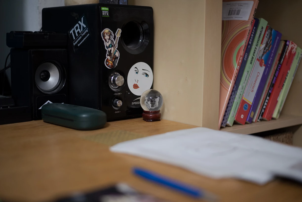

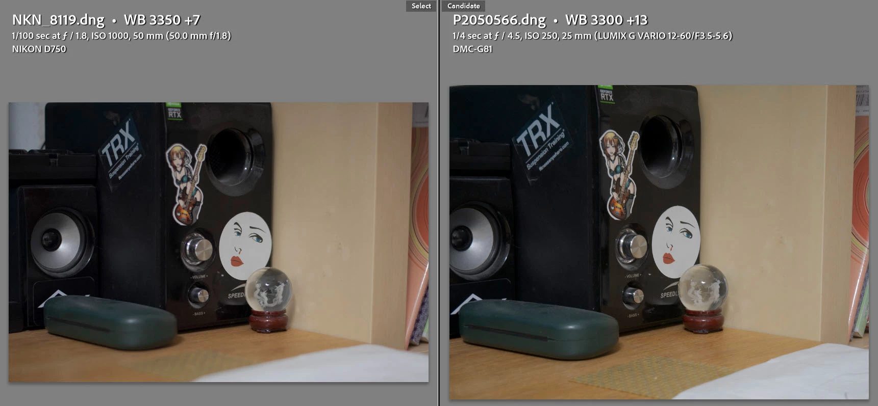

Here's a screenshot of the two files with WB 3350 + 7 for the NKN_8119.dng and 3300 +13 P2050566.dng and all other settings at 0 defaults with Adobe Neutral profile.

"This is not a WB issue either, as that remains unchanged."
In the DNG files uploaded you have the WB set to 3300 +8 for both of them. The assumption being that they were shot with the same lighting so should have the same WB settings. Using the LrC WB Eyedropper on the white area of the face decal on the speaker I get 3350 + 7 for the NKN_8119.dng and 3300 +13 P2050566.dng. It's a small difference, but typical for different camera models or even the same model camera. With these WB settings and all of the other settings at 0 defaults they look very similar with the Adobe Neutral profile. If you want to get closer color matching I suggest purchasing a Color Checker Passport and making custom dual-illuminant profiles for both cameras. More details at the embedded links.
