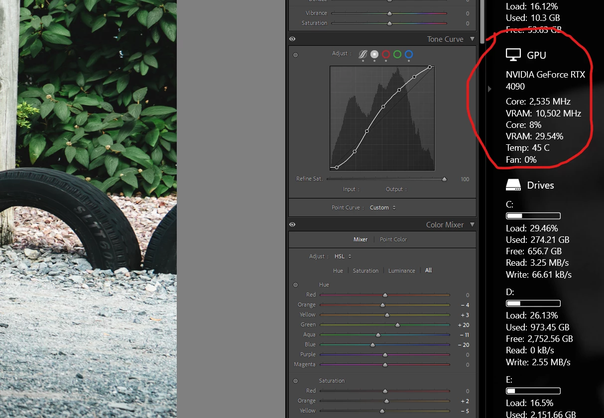

Is it normal for Lightroom Classic to take up this much VRAM for my 4090 GPU?
  • September 10, 2023
  • 589 views
There are times when it almost maxes out at 93% which seems excessive considering my current setup has 24gb of vram. My nvidia studio drivers are up to date. I've tried re-installing lightroom and, and the drivers. Does anyone have experience with this?

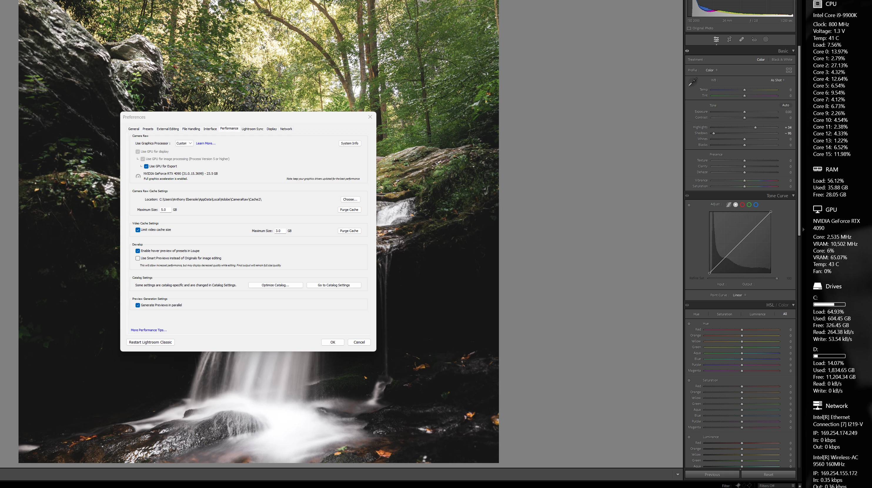

P.S. Do you have a screenshot of whatever was telling you that so much VRAM was in use? That value in 'preferences/performance/ is the perceived by LrC available amount, not the in use amount (could be wrong)
I do not doubt that your LrC performance is bad. I do not doubt that LrC is using a lot if VRAM. Not with such a small amount of allowed CACHE. (this would be seen in develop module performance)

The screenshots are from sidebar diagnostics. The first screenshot is upon opening lightroom. The second is after some editing using a few layers of different masks.
