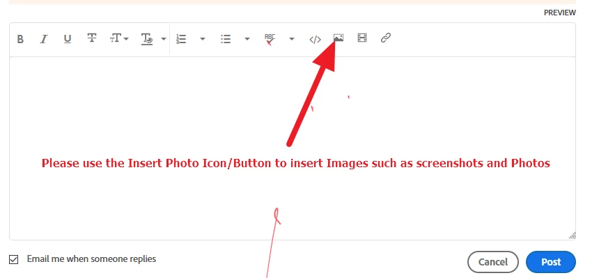

Ok, ignored or overlooked the attachment . Many user refuse to bring up attachments. Cyber security concerns, and quite frankly, clunky.
In the future please use the insert photo button
