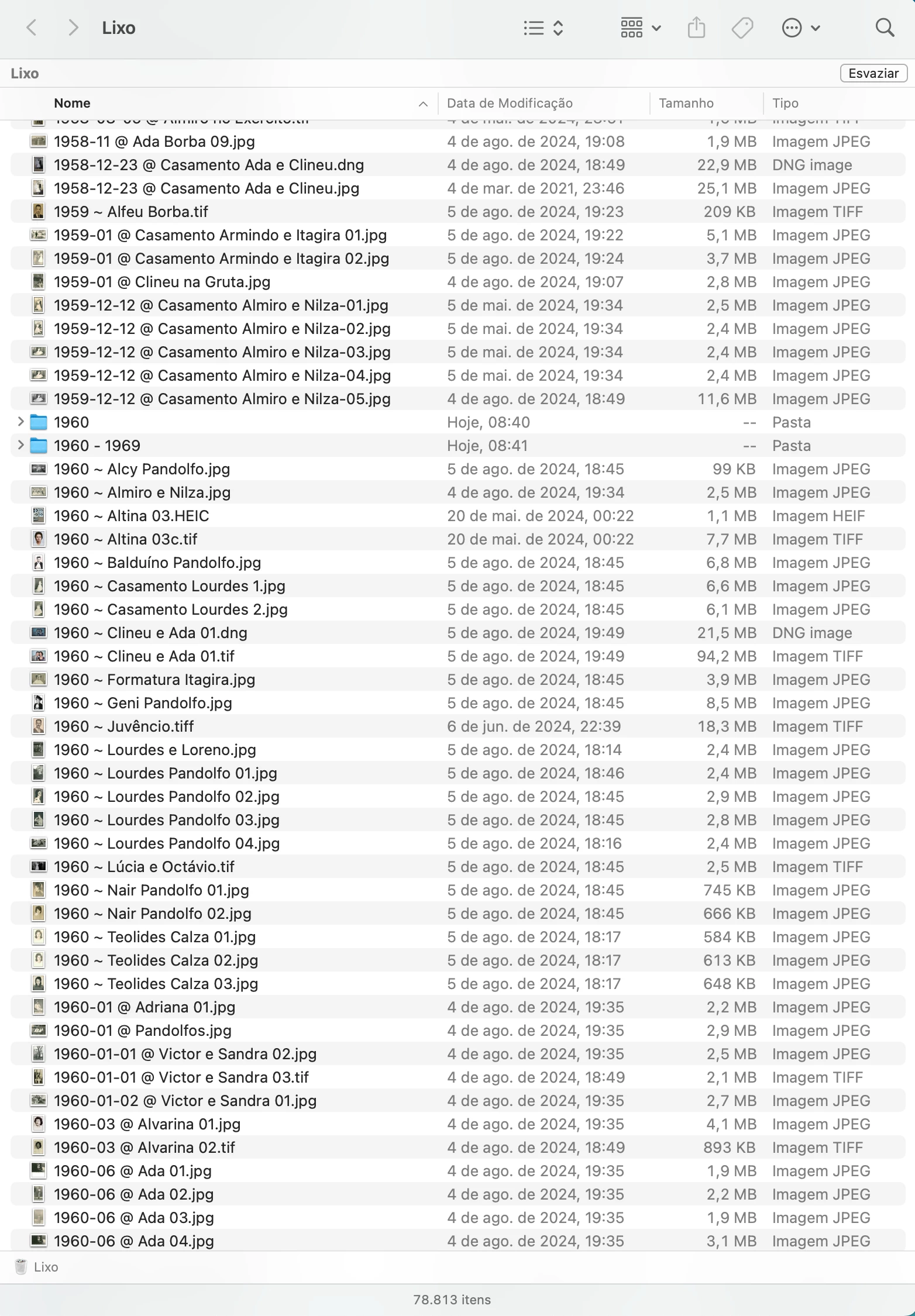

Immediately 25,000 photos and travel folders relating to a first-level folder were sent directly to the OS trash.

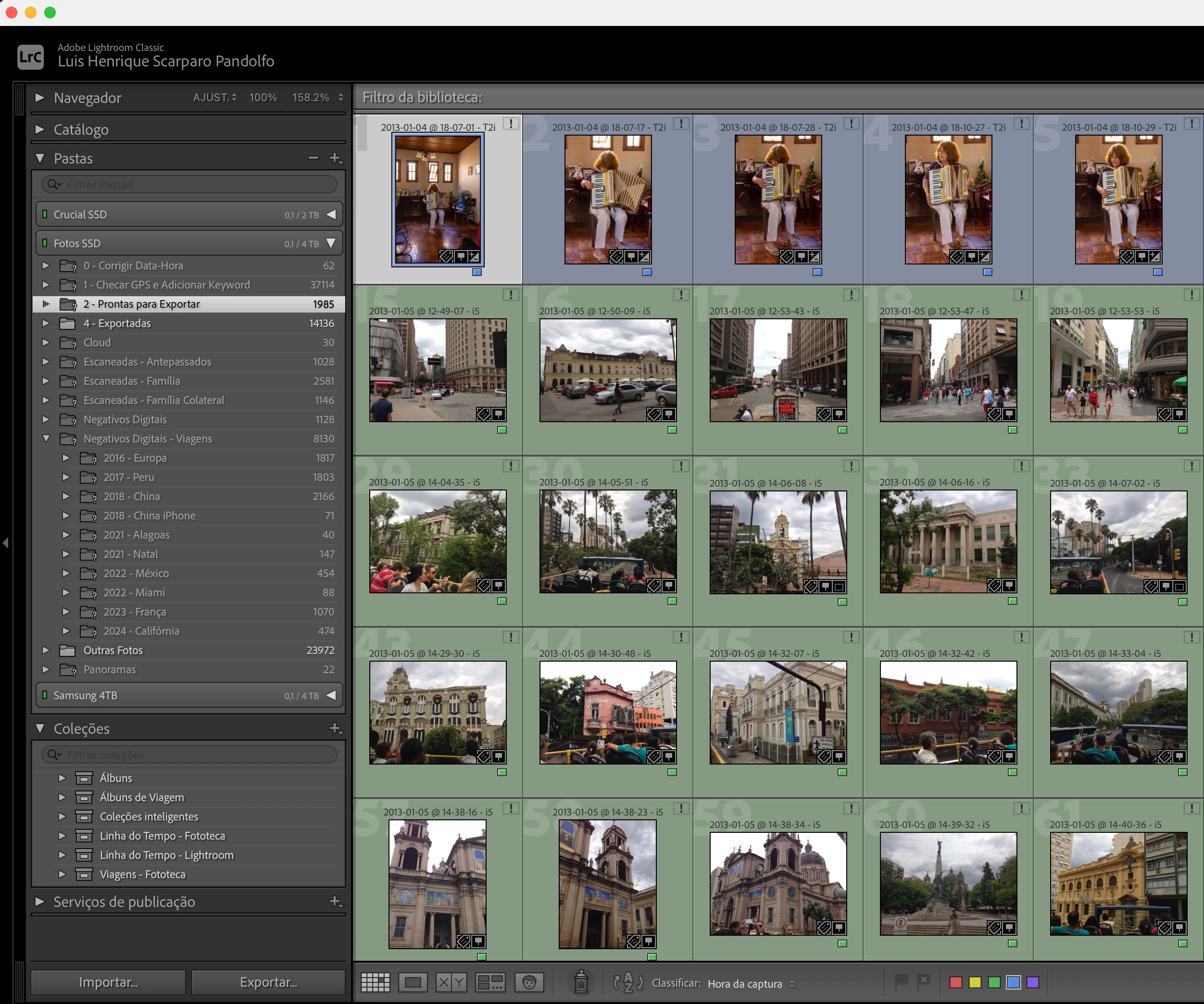

Next, Lightroom started to display folders with a location not found sign for photos and folders (question mark).

After recovering the previously deleted photos, I opened Lightroom again and now, at once it threw ALL my photos and folders to the OS trash.

Luckily I have a backup, but the restoration process will be painful, given that he sent 78 thousand photos to the trash (on macOS he throws everything out of the folders), in other words, there was no hierarchy of photos and folders.
