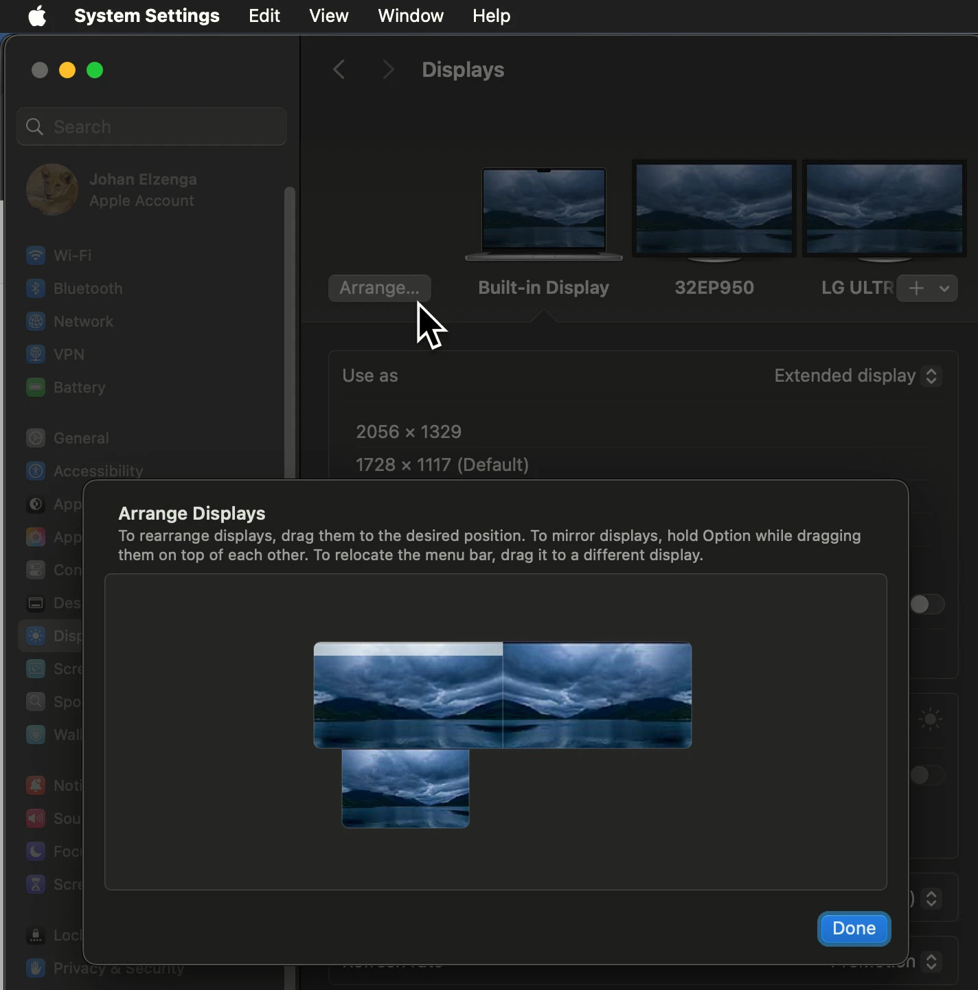

JohanElzenga
Aug 26, 2025 4:19 PM UTC
How did you setup that display in MacOS System Settings? Here's how I have setup the same MBP with two displays. I have turned off the option to treat each display as a separate space, and the main display has the menu bar. Lightroom runs on the main display without any glitches.
-- Johan W. Elzenga

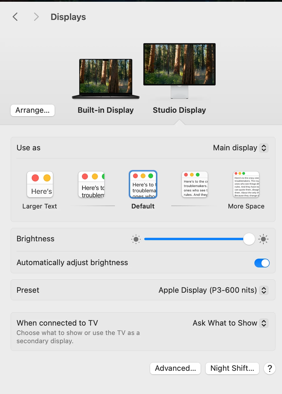

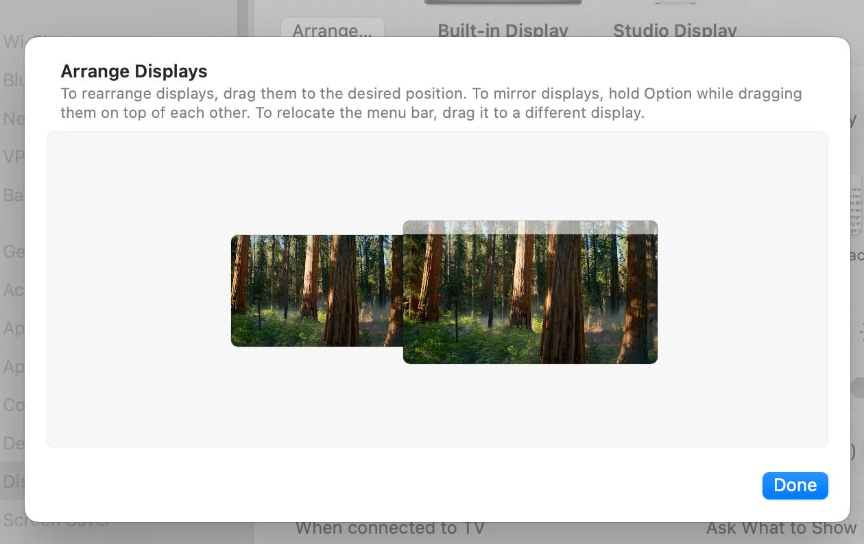

Maksym33291927omw7
Aug 26, 2025 7:39 PM UTC
That's how it's looks here's
