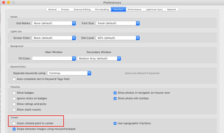

    As Just Shoot Me has already indicated, a screen shot  would help. In meantime, check whether the preference for 'Zoom clicked point to center' is enabled. If it is then disable as shown in below screen shot

    I have ticked the zoom clicked point to centre and will see next time I import some photos.

    In that case, best you have 'Zoom clicked to center' enabled (checked). This way, when you click on the 'subject' it will zoom in the center of your screen.
