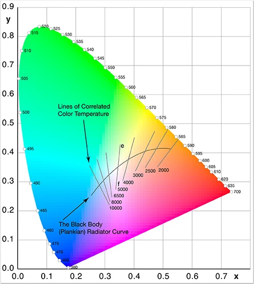

Does anyone know what Kelvin values convert to on the -100%-100% temperature scale on Lightroom?
Kelvin defines a pretty large differences in colors as seen below; all software interperpates the colors differently. It isn't at all uncommon to see different values reported from the same raw file in two different products. Bottom line, any CCT values is a range of possible colors:
