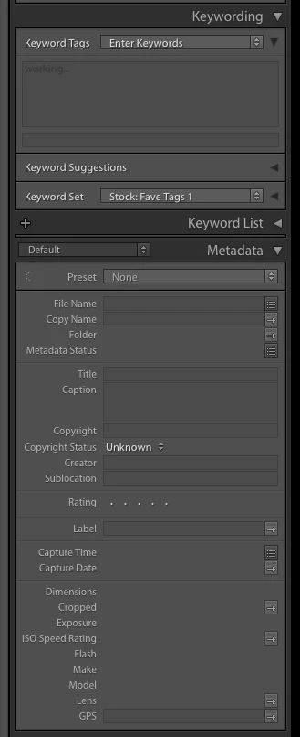

I recently "upgraded" from Lightroom v6 to Lightroom Classic CC v7.2. I've had nothing but trouble since the upgrade.
The main problem of many is that when I select an image, the Keywording panel simply displays "Working...", sometimes returning between 1 to 10  minutes later with the correct keywords, but usually never returning at all.
The problem seems to be intermittent, but will usually happen after the program has been running for about 20 minutes, and will happen even if nothing has been done since starting the program.
Restarting the program will solve the problem briefly, but is obviously not a great solution as it severely disrupts my workflow.
Anyway, has anyone else seen this issue or know how to resolve it?
My catalogue has around 31000 images and about 15000 keywords, and I'm running on a 2010 iMac with 12Gb RAM, 3.2 GHz i3 processor and macOS High Sierra 10.13.4.
Thanks in advance for any help...

    Unfortunately, switching images simply compounds the problem, as after it has taken time to retrieve keywords and metadata for the first selected image, it then goes through the same process to obtain the data for the next image.
    Eventually, it stops retrieving data for any image, and even though you can enter new keywords, and change metadata, the information you provide isn't remembered after a restart.
    You basically have to restart the program to get it working again.
