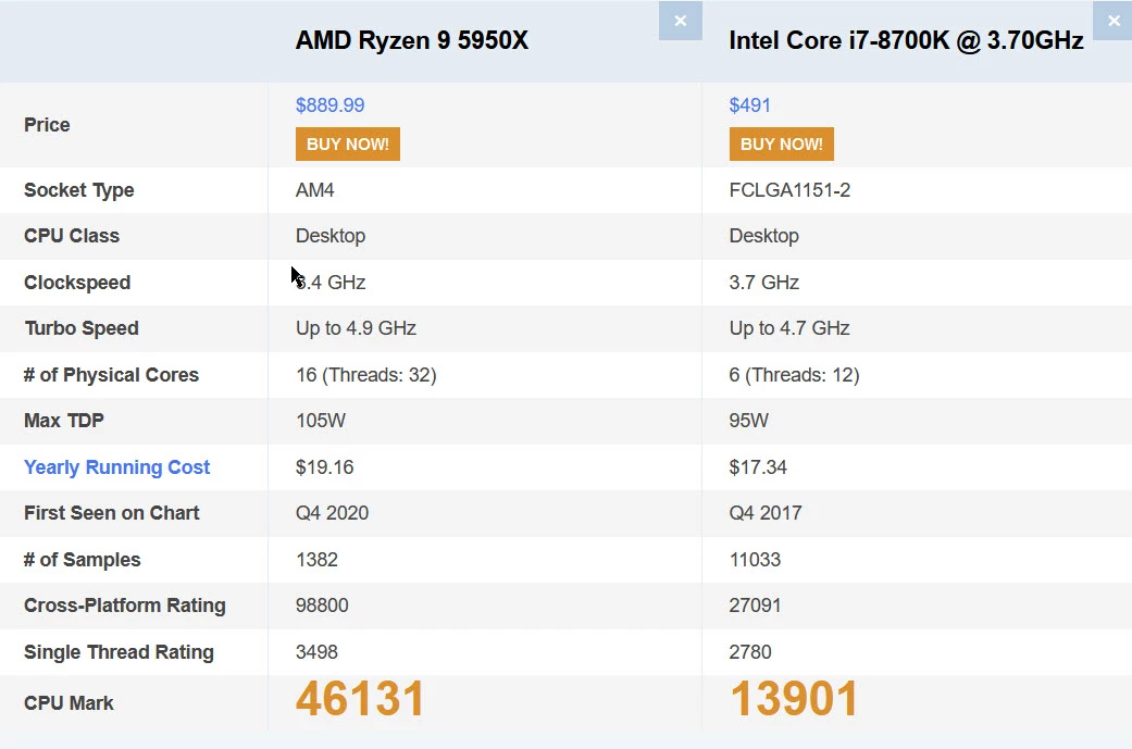

I have a similar system using a much lower performance Intel 8700K with no issues. I doubt it's due to the AMD 5950x CPU.

I just have the GPU and a PCIe Gen 4 SSD. Well, also a few SATA devices (an 500GB SSD, a 4TB magnetic drive and blu-ray drive).
And I do find it quite difficult to believe that the 5950x would perform worse than the 5820K. At least the benchmarks (single/multi core), are with the 5950x by a big margin. 😄
