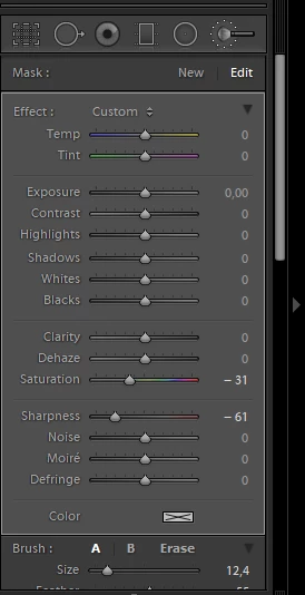

Last four sliders (sharpness, noise, moire, defringe) in my adjustment brush are not working. As I move these sliders it's making no difference to the image. All the other sliders (e.g. saturation) work properly. Flow and density is set to 100. The pin and mask overlay is selected. What's wrong?

    Sharpening in my Detail panel is set like at this screenshot.

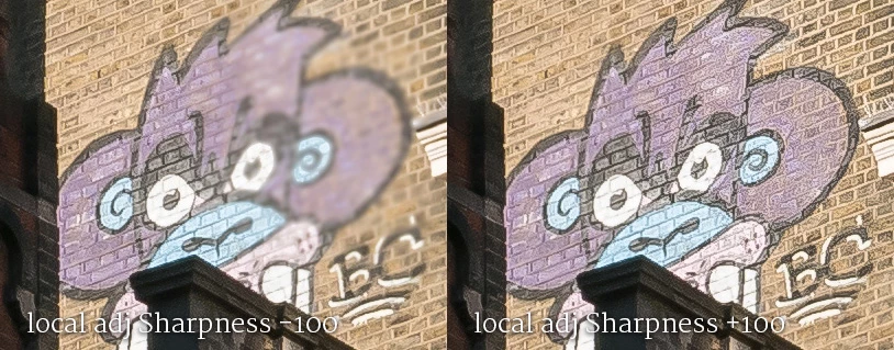

    If you have applied a lot of global sharpening (in the Detail panel) then the Sharpness slider in the local adjustments can make a large visible difference as you slide it from -100 to +100. That's because local adjustments adjust what picture data is input to the global sharpening, which then exaggerates that.
    If you have little or no global sharpening set, there is correspondingly less visible result from the local tool since edge contrast is not being "multiplied up" by that.
