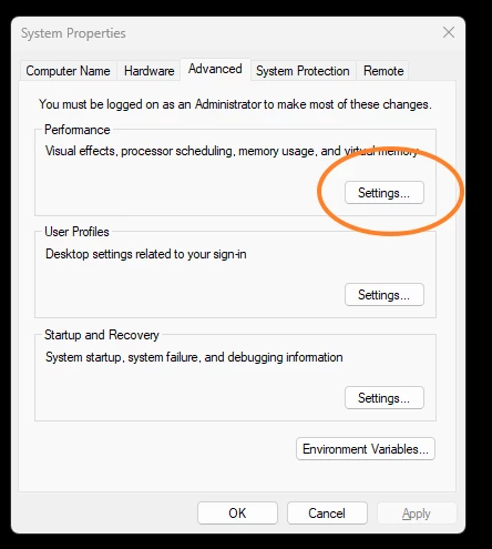

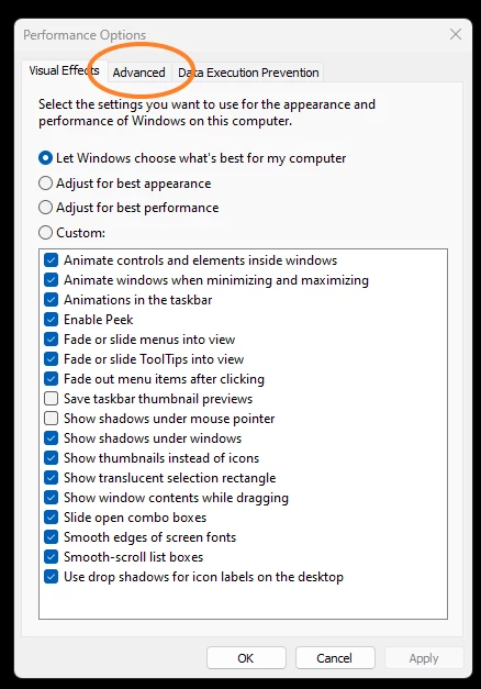

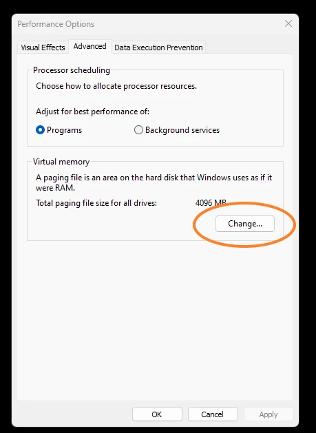

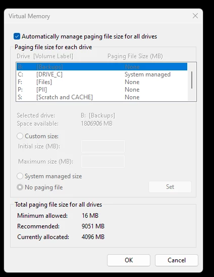

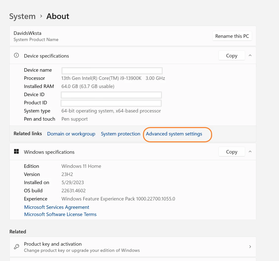

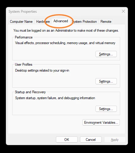

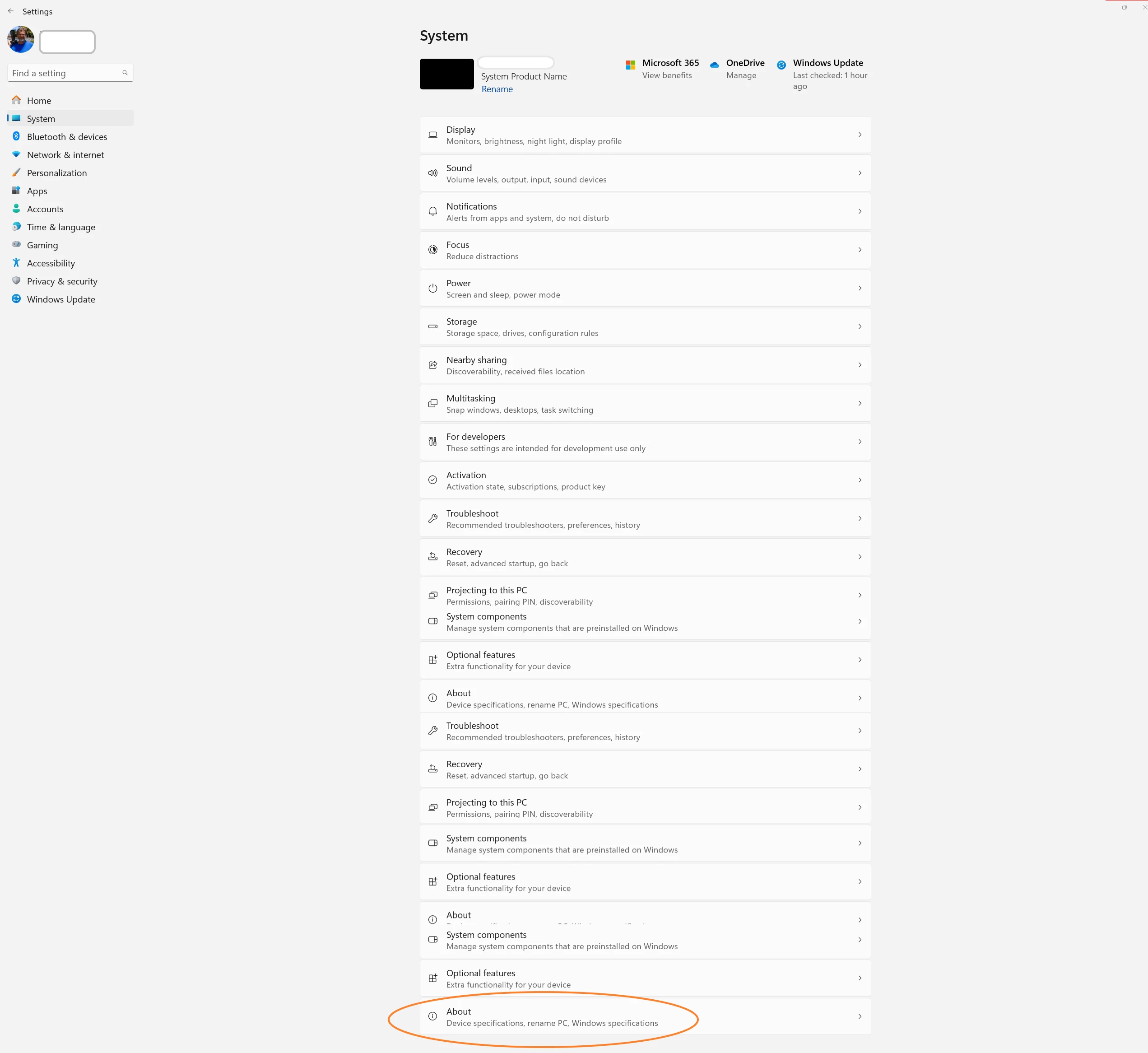

So about the Windows Paging file
1. Open Settings.
2. Click on System.
3. Scroll down and click the About.
4. Click the "Advanced system settings" option under the "Related links" section
 5. System Properties comes up, click the Advanced tab
6. Click the Settings button under the "Performance" section
7. Click the Advanced tab again.
 8. Click the Change button under the "Virtual memory" section.
9. And perhaps share in a reply a screnshot of this:
