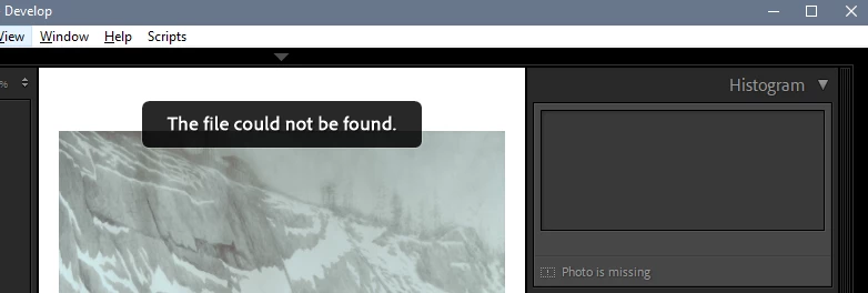

Are you sure that the originals are not missing?
If you open an image in Develop, do you see this?
If everything is normal in Develop, and you are absolutely sure that you are not working with smart previews (it will say Smart Preview below the histogram if you are), try resetting the preferences.
