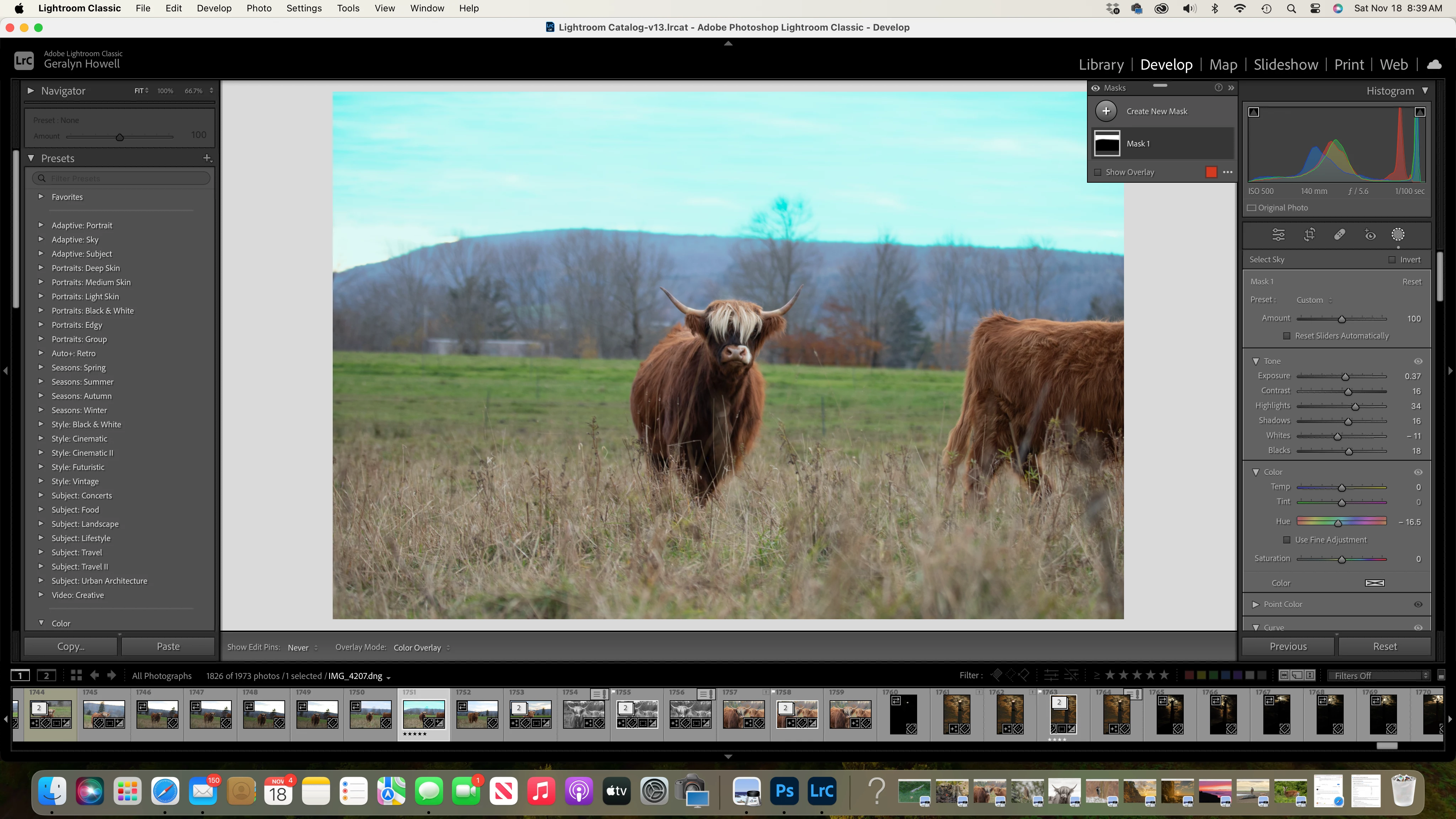

 Hi Johan, the "embed" button would not work for this request. Can you work with this? I appreciate your assistance.   It started to happen after the last update.  When I use mask tool it turns whatever I mask to green.  The red mask overlay I always use is not selected.    I have tried to determine issue to no avail.
G.
JohanElzenga
November 18, 2023
Your mask adds a Hue shift of -16.5 to the sky. That will turn blue into a greenish color. If that happens to all masks, then look at the top of the mask panel. There you can set the option to reset all sliders when a new mask is created. This is unchecked right now.
