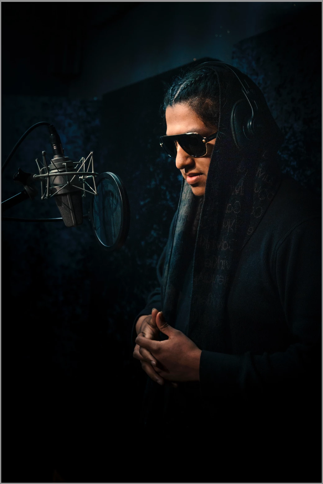

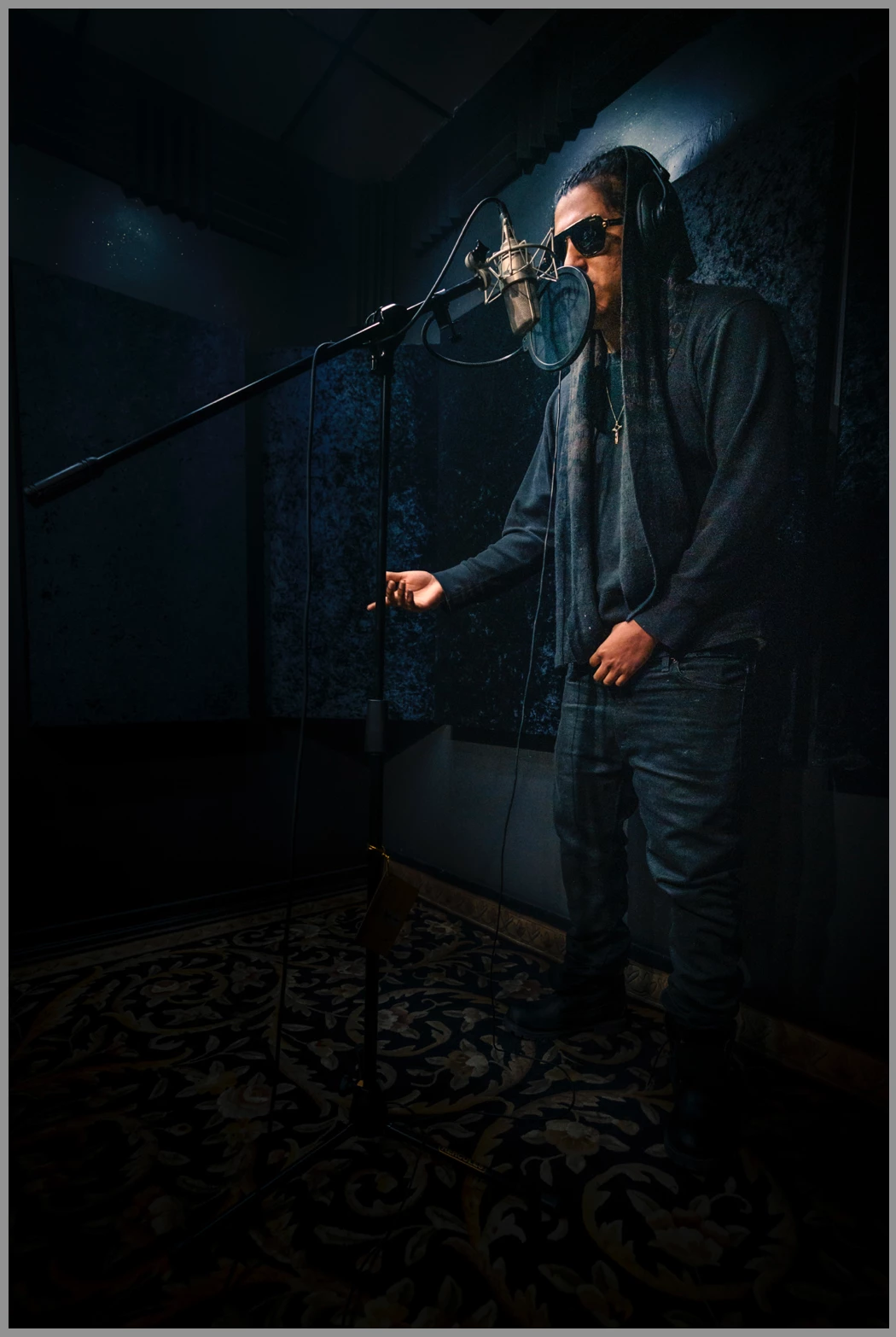

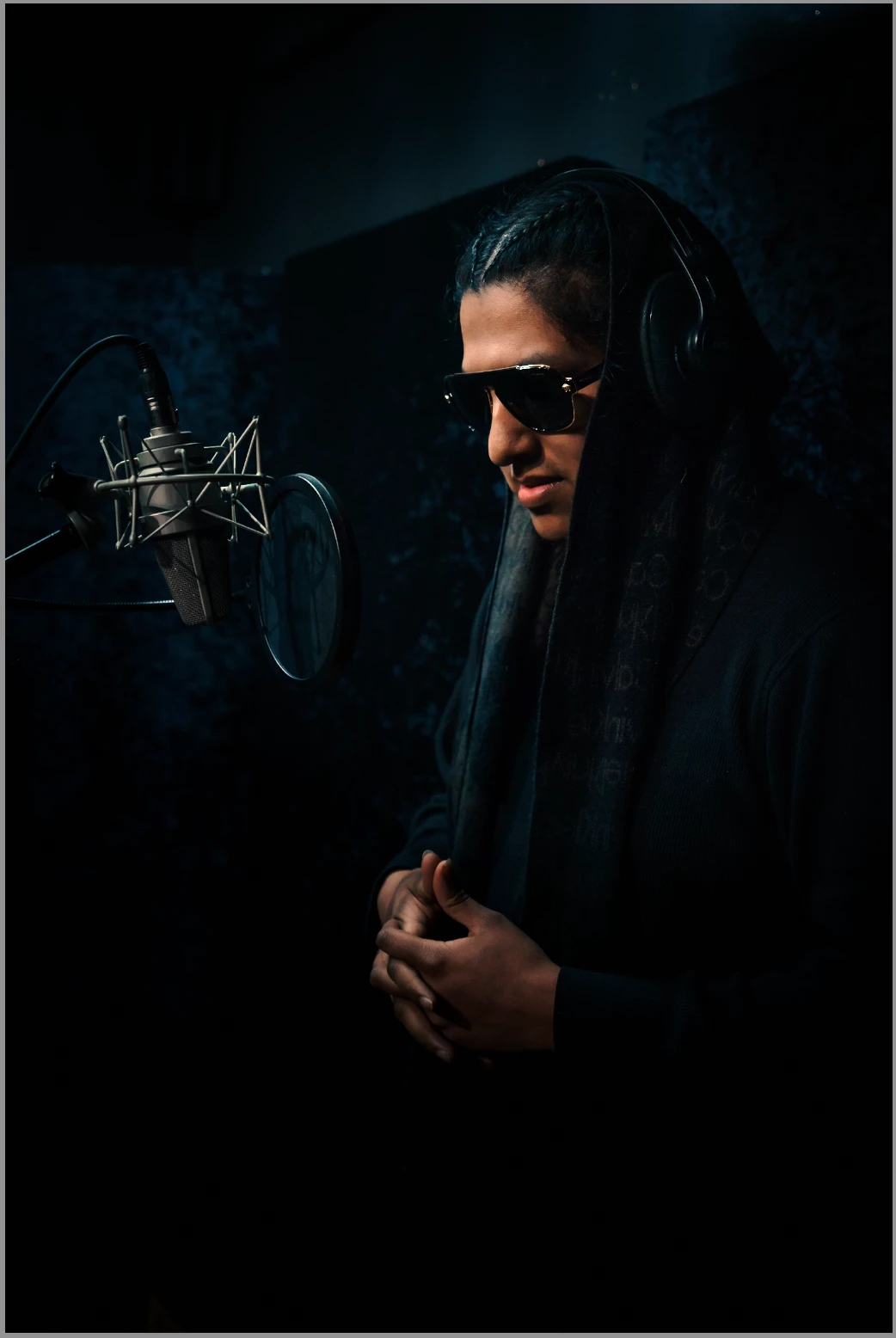

Not sure what the issue is here. I was editing my photos and noticed on export some of them looked drmatically worse, lighting adjustments wise. When I checked them out in library module, they looked like they did on export - but not what they looked like in develop module. Ive uploaded a couple of examples of the worst offenders.
I notice there is overlightining and added noise (seems like it's canceled my noise reduction adjustments) in the library versions...

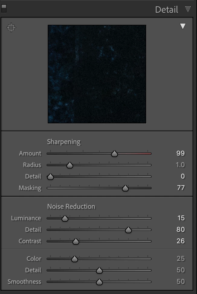

Did you try my suggestion? Your high 99 Sharpening and low 15 Luminace setting are causing the differences to appear as explained in my reply.
At 1:1 100% view try adjusting the Detail panel settings to reduce visible noise, which should make the Library and Develop module previews look near identical.

March 9, 2021
In the first image, which seems most obvious to me, the ISO is 2000. Attached is a screenshot of the detail panel for that image.

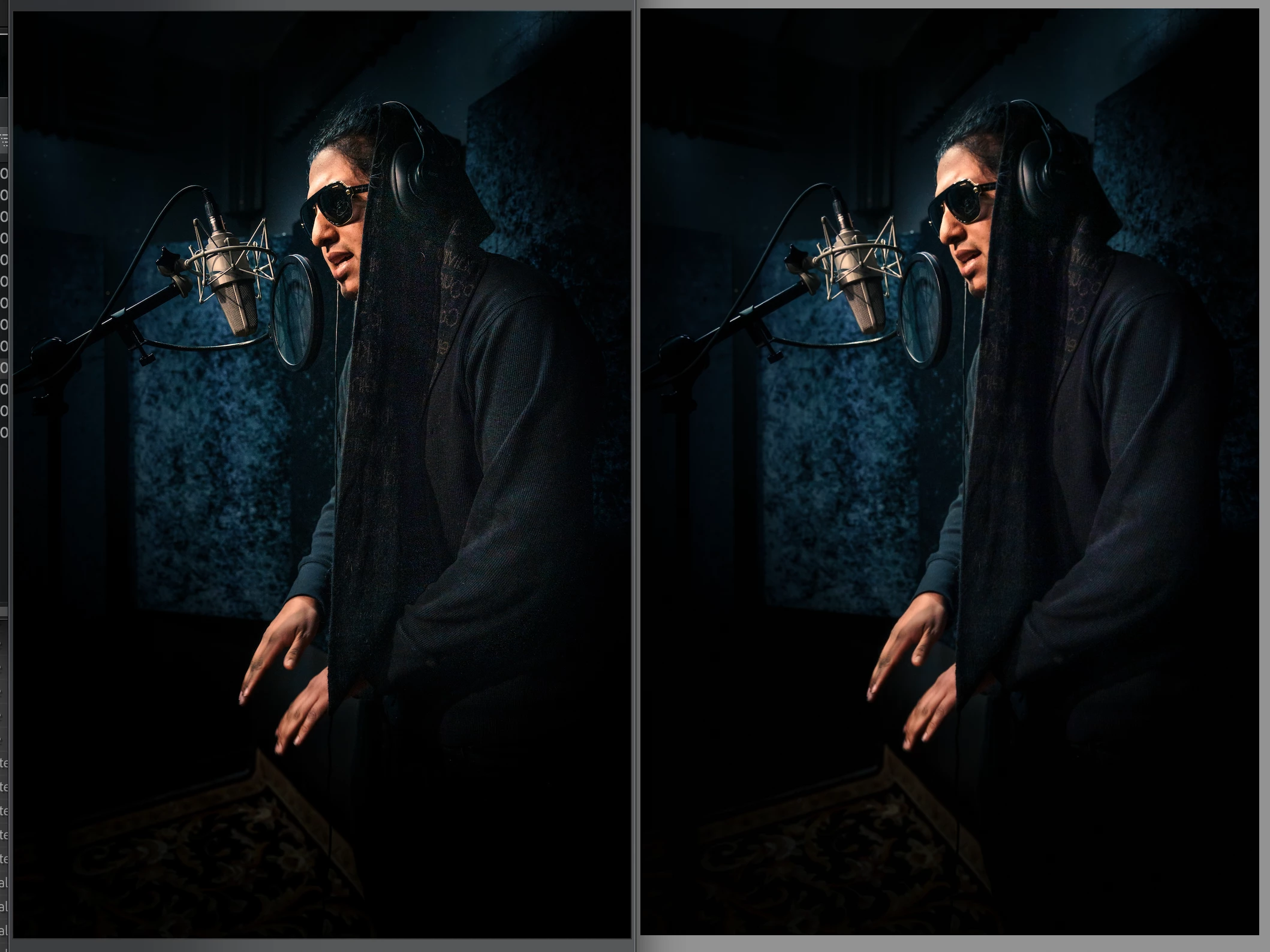

ostettd
ostettdAuthor
March 9, 2021
Here is a side by side. Left is exported photo, right is photo is develop. Notice the skin/hair is softer on the right. The most noticeble light change is on and just below his headphones. Overall there is more grain and sharpness on the left (exported) than on the right (develop module).

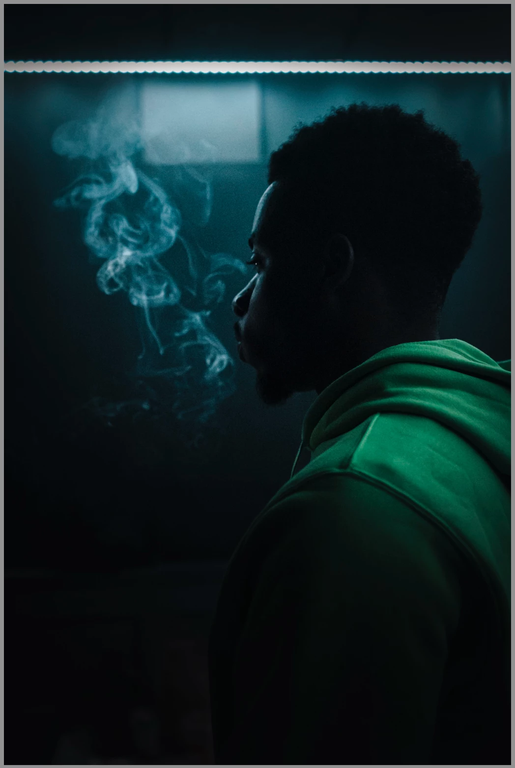

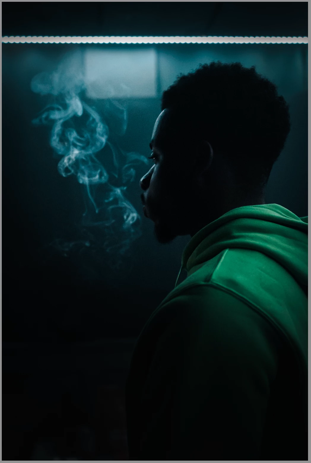

ostettd
ostettdAuthor
March 8, 2021
Heres another one, side by side. All of the rich blacks get crunched and look super noisy and discoloured. There seems to be a slight green hue as well...
