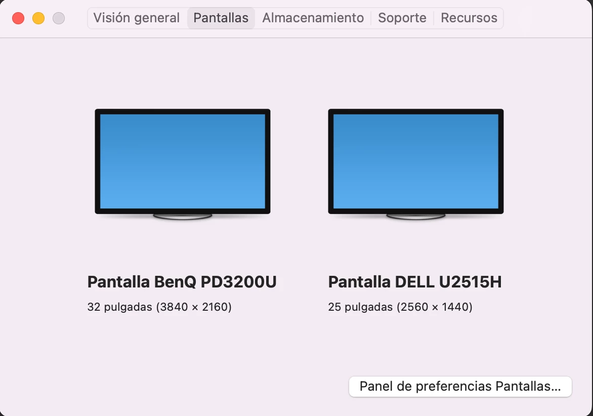

What type of edits are you applying to the images? What size/resolution of monitor are you using?

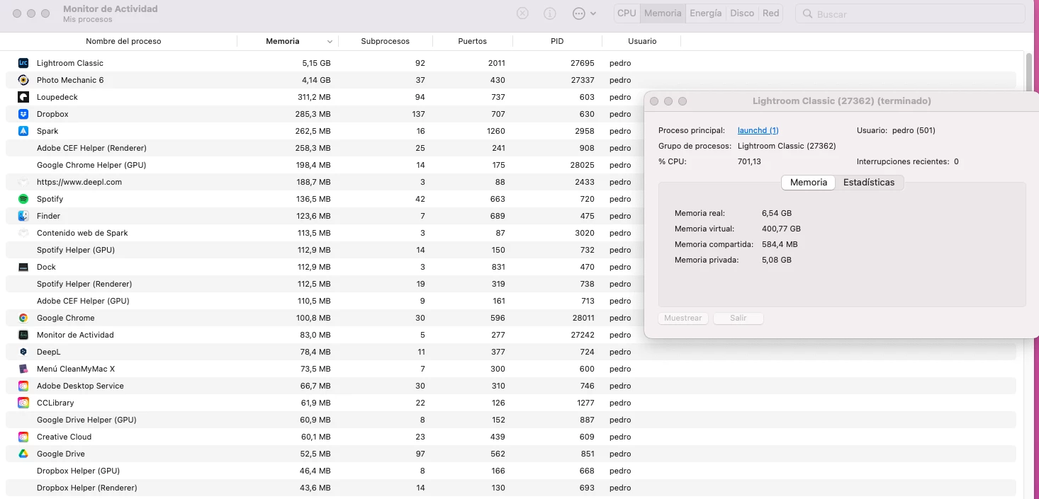

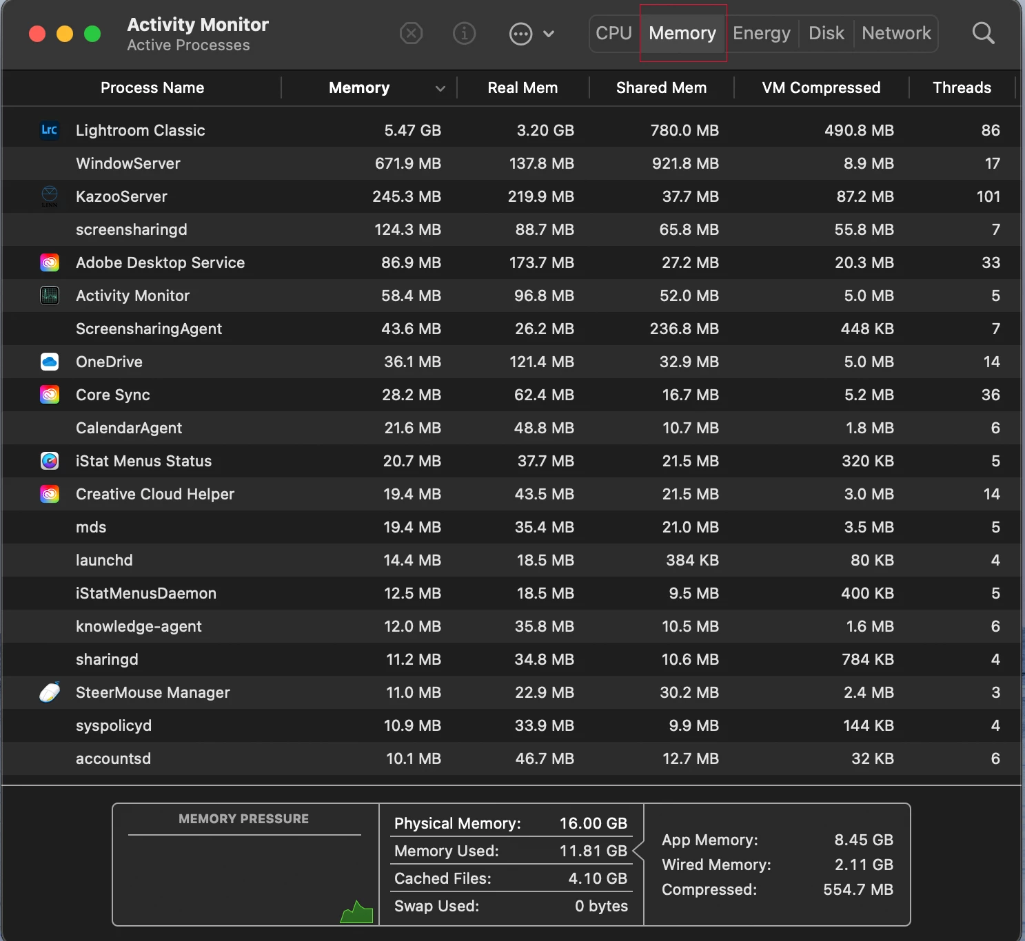

Also, can you upload a screenshot of Activity Monitor > Memory tab when Lightroom becomes slow. I've highlighted the button to use for uploading images to the forum in attached screenshot and included another screenshot of what we need re Activity Monitor.

I'm using normal presets to edit the color, nothing special.
Please find some screen captures.

The screenshot of Activity Monitor is indicating that LrC is running the CPU at 70% yet memory use is relatively low if working in the Develop module. Were you building previews or exporting while taking the screesnhot?
Other things that will impact on your performance is using two displays, especially one being 4K. This a bit much for 16GB, especially as the GPU will use a lot of this shared memory whilst editing in the Develop module. You're also running Photo Mechanic, which accounts for another 4GB plus of the memory shared.
It would have been helpful if the Activity Monitor screesnhot had included the section at the bottom. This area shows how much, if any swap is being used.
