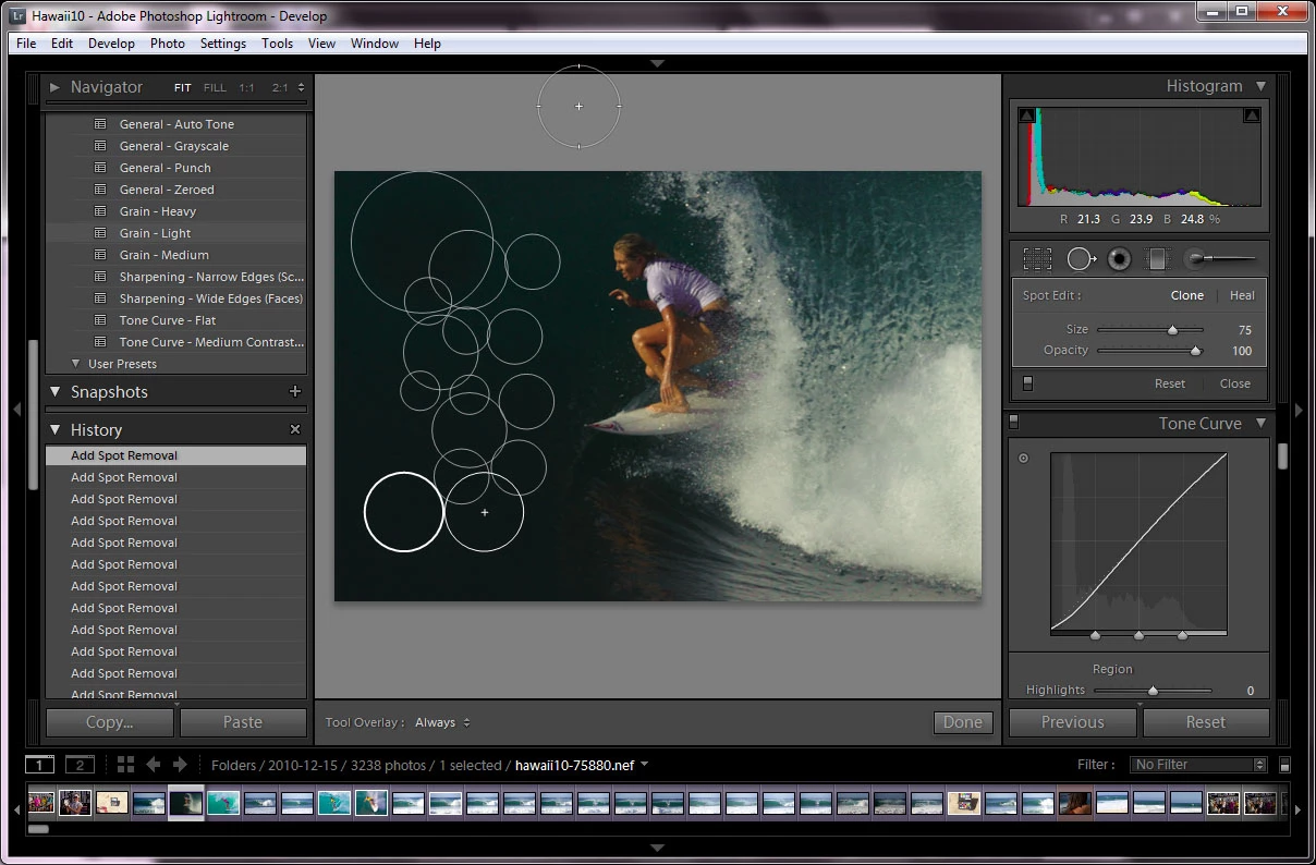

    December 18, 2010
    The below example of my spot removal on a raw image runs excruciatingly slow.  There is an enormous page fault rate during this slowness, all the while memory and processor are going unused.  Anyone can duplicate this problem by slapping about that many dust spots against any uncropped raw image.    Fix this situation, and I will bet the same solution fixes a lot of other problems as well. Thats just my educated hunch.
    Sean McCormack
    December 18, 2010
    That isn't actually a lot of spots. I generally have way more when working on faces. What version of Lightroom/OS etc?

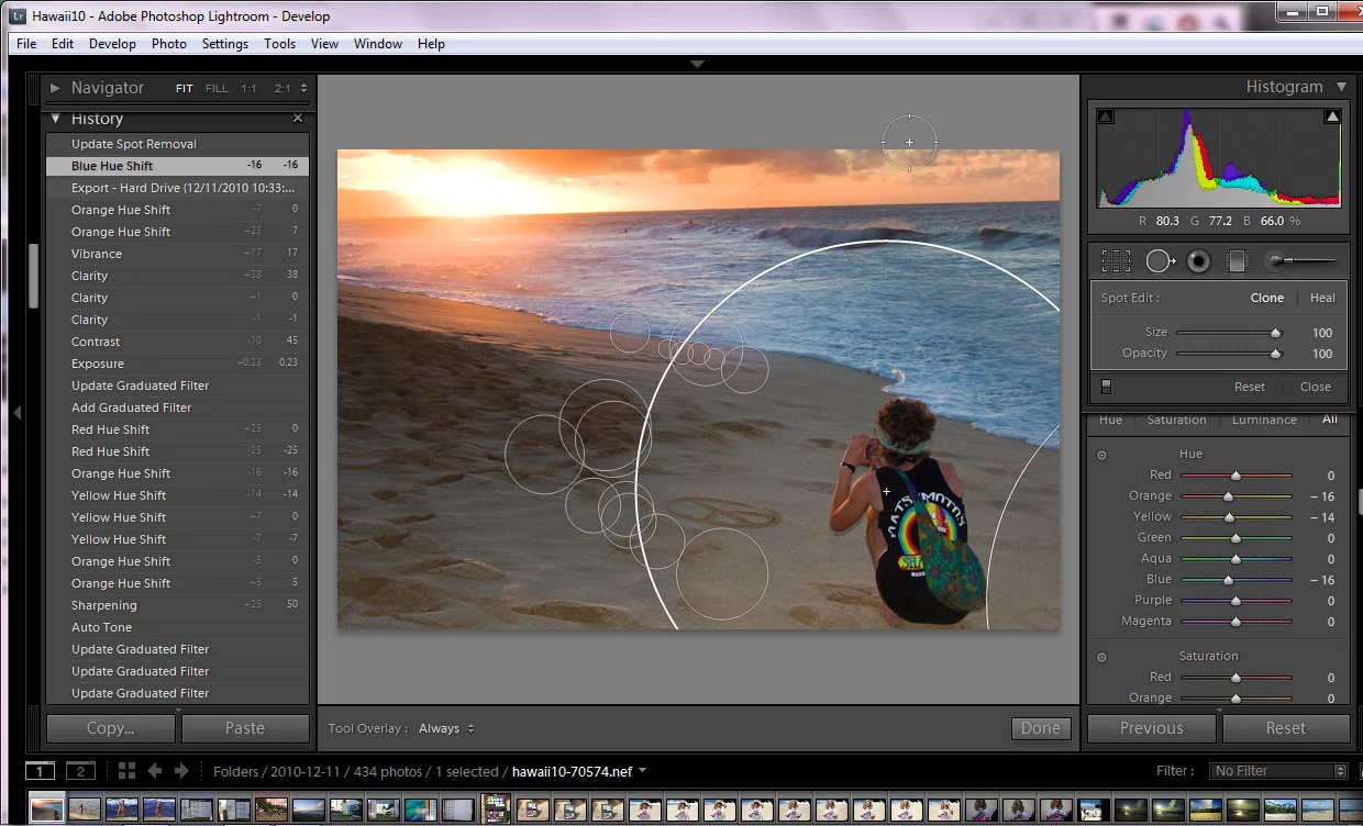

    December 18, 2010
    It's LR 3.2 on Windows 7, the above image is slow both on a relatively limited laptop, and a desktop I-7 with 12gb ram.  The size of the spot seems to make a difference, and in all my examples they are relatively large.   It slows way down after 4-5 spots, especially if you start resizing existing spots. --It is often faster to delete and replace a spot instead of resizing it.
    In the below example they are even larger (but harder to see) and the goal is different --to actually rearrange large objects with detail and create a work of fiction.  The term "dust spot removal" suggests that this use may not have been tested for.  But it is nonetheless a very cool, albeit slow capability.
