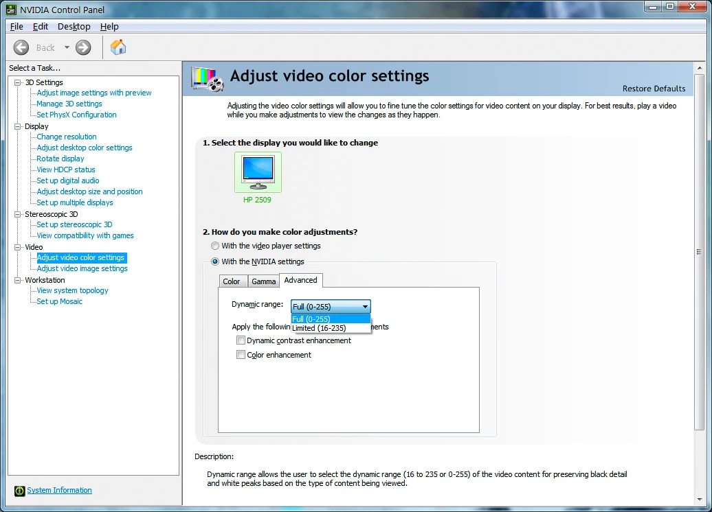

February 18, 2014
I had a similar problem with video on my WIndows 7 system where blacks were washed out. It was an issue with the Nvdia graphics driver video color settings under 'Advanced.' The default settings is 'Limted (16-235)' and changing it to 'Full (0-255) corrected the issue:

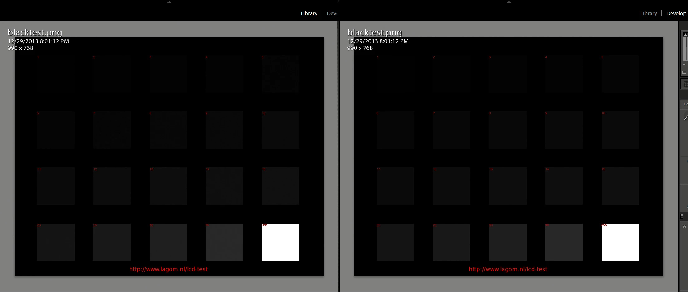

December 30, 2013
Try the Black Level test pattern at Lagom:
http://www.lagom.nl/lcd-test/img/blacktest.png
Right-click on the image and Save it. No profile is assigned, but it's sRGB. Inside LR I can see the patches all the way down to patch Level 1.
Check it in both the Library and Develop modules and inside PS.
On my Windows 7 system with LR5.3.
Message was edited by: trshaner Added screenshot
