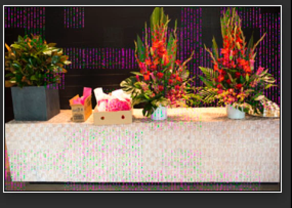

I am having the same issue with my 2015 Macbook. Lightroom was working perfectly fine then under load for some reason it strained and have not been able to use lightroom since. keeps crashing after loading and when it does load for the few seconds I have a weird apperance on my images as per attached.
