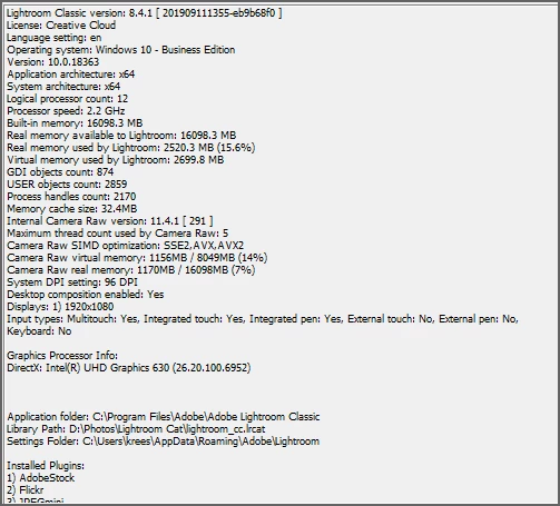

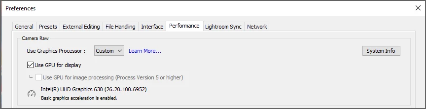

On my Dell XPS 9570 with the NVIDIA GeForce GTX 1050 Ti with Max-Q Design, Lightroom 8.4.1 only recognises the Intel UHD Graphics 630 and cannot see the NVIDIA GeForce card.
Brush editing is painfully slow and delayed.

    I wonder if something is set wrong in your NVIDIA  Control Panel?
    to access the control, see:
    https://www.winhelp.info/boost-lightroom-performance-on-systems-with-nvidia-graphics-chip.html

    As you have Lightroom v8.4.1, I assume you have Photoshop.
    How is your GPU treated in Photoshop?
    Go and bring up the System Information as reported by Photoshop, and share that.

    September 24, 2019
    Consider solution 4 in:
    https://helpx.adobe.com/lightroom-classic/kb/troubleshoot-gpu.html
    But, this is not normal. Get the latest GPU driver, and even if the same as already installed, accomplish a clean install.
    September 24, 2019
    Sadly tried that without any luck. If the Intel graphics is disabled in the Device Manager, then the GeForce appears. Very strange behaviour
