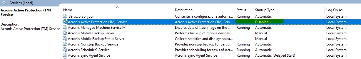

sandroriz
sandrorizCorrect answer
Nov 12, 2019 7:22 AM UTC
I resolved also the second issue (slow drawing the lines of the Upright Guided command) stopping a service called Acronis Active Protection. Stop it and set startup to Manual or Disabled

sandroriz
sandrorizAuthorCorrect answer
nathanr57706027
Nov 23, 2019 3:12 AM UTC
Just had the same issue. Disabled Acronis Active Protection (as suggested above) and I return to getting acceptable (not brilliant) performance. Thanks for the tip - would never have guessed that an unwanted service bundled to my backup tool would cause cropping in Lightroom to be slow.

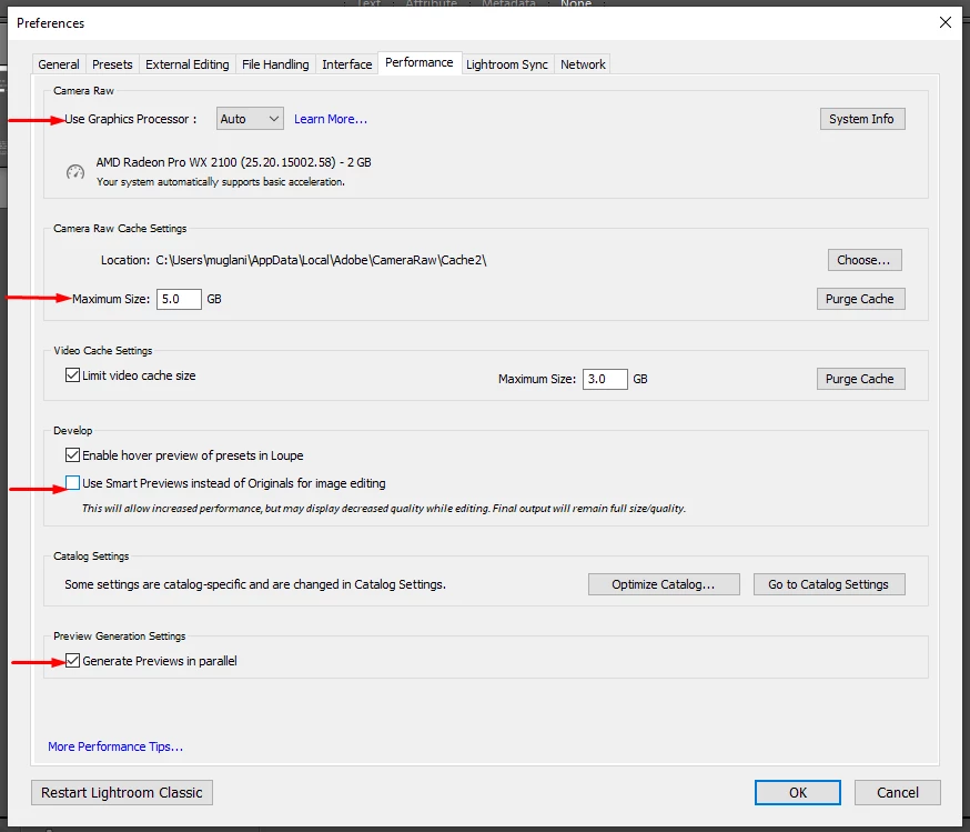

nikunj.m
Nov 5, 2019 9:15 PM UTC
Hi there,
We apologize for the issues you are facing with using Lightroom Classic on your Dell Precision machine.
Would you mind checking the below mentioned details and performing the steps to check if it helps?
  1. Go to Preferences > Performance and increase the Camera Raw Cache size to 10.0GB or more.
  2. On the same tab, check the option to Use Smart Previews instead of Original for image editing and uncheck the option to Generate Previews in Parallel.
  3. On the Performance tab itself, select off from the drop down for Use Graphic Processor
  4. Go to the General tab and check the box to Replace Embedded previews by standard previews during idle time.
Once you have made the above-mentioned changes, quit and relaunch Lightroom Classic prior to testing the application.
You can also check the steps mentioned in the article linked below.
https://helpx.adobe.com/in/lightroom-classic/kb/optimize-performance-lightroom.html
Nikunj
