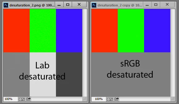

    You shouldn't have equal density for all colors, because that doesn't take into account the inherent lightness of a color.
    A fully saturated yellow is a very light tone that should be represented by a very light gray. A fully saturated purple should be represented by a very dark gray.
    The Lab color model has this built in, but the RGB model doesn't. A desaturated bright yellow is middle gray, the same value as a desaturated dark purple. So you need to compensate for this particular shortcoming in the RGB model.
