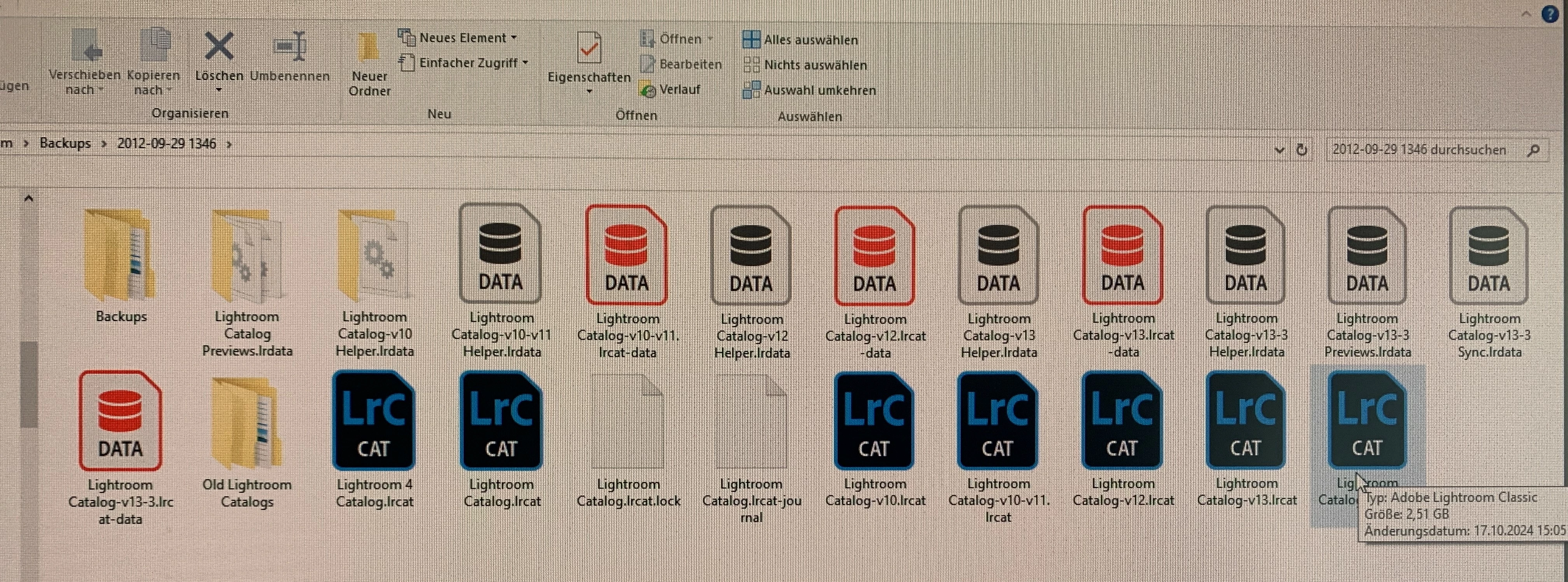

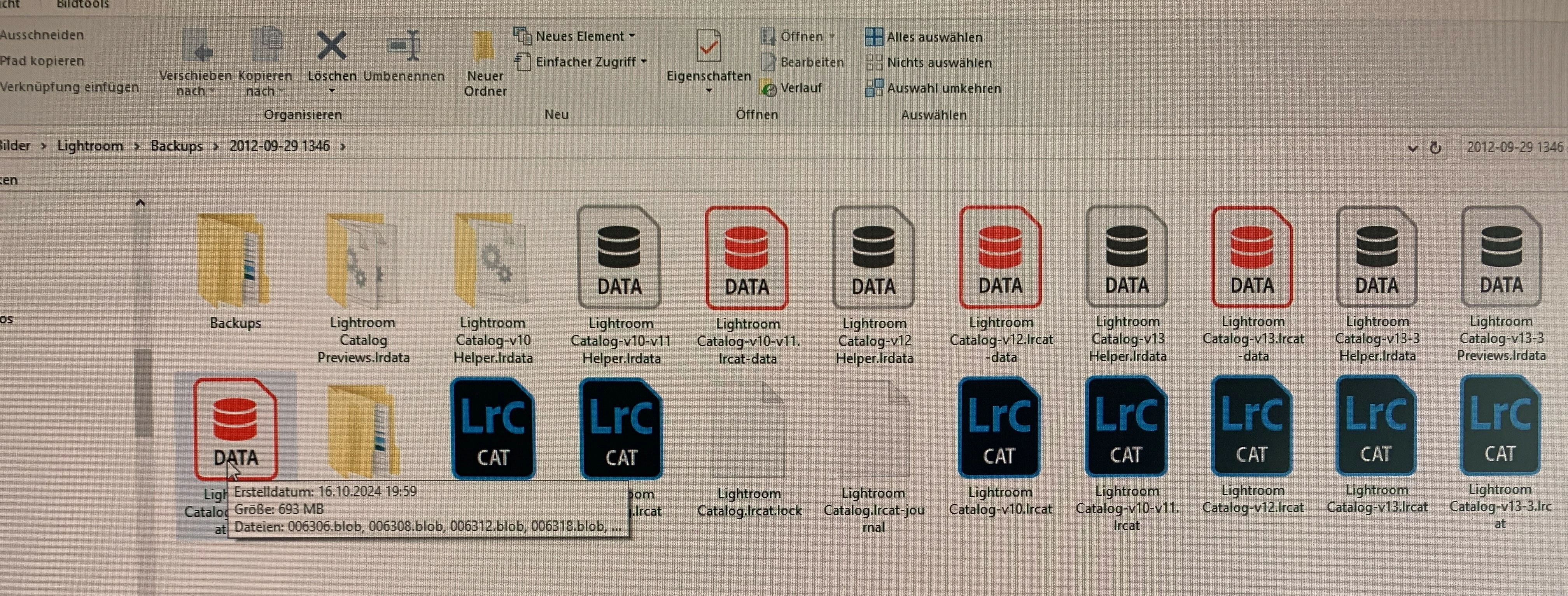

    The folder that you are in as shown in those screensots. It appears to be a backup folder. Is that the case? The catalog in that folder, is that a working catalog or a backup?
    If a backup, then yo need to copy it to a different folder, and uncompress it. You may or may not need to copy that lrdta file as well (not sure if it is compressed)
    If the lrdata file is missing, then LrC should recreate it.

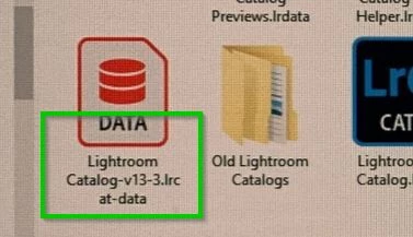

    Looking at your screen-clips-
    { Lightroom Catalog-v13-3.LRCAT } appears to be your most recent catalog-
    There does exist  the companion file that contains the AI masking data- (The topic in the error message)
    So what happens when you open the { Lightroom Catalog-v13-3.LRCAT }  catalog.?  ([Double-Click the .LRCAT file in File Explorer)
    "If you continue, the any catalog will open,"
    The most likely answer is that Lr-Classic is 'opening' an older catalog that does not have any AI data (maybe one from those vast backup folders).
    It is no major problem to open any catalog with a missing AI data file as the file will be automatically created.
    Have you recently upgraded to v14.0.1?
    In LrC preferences double check to see which catalog is opening by default.

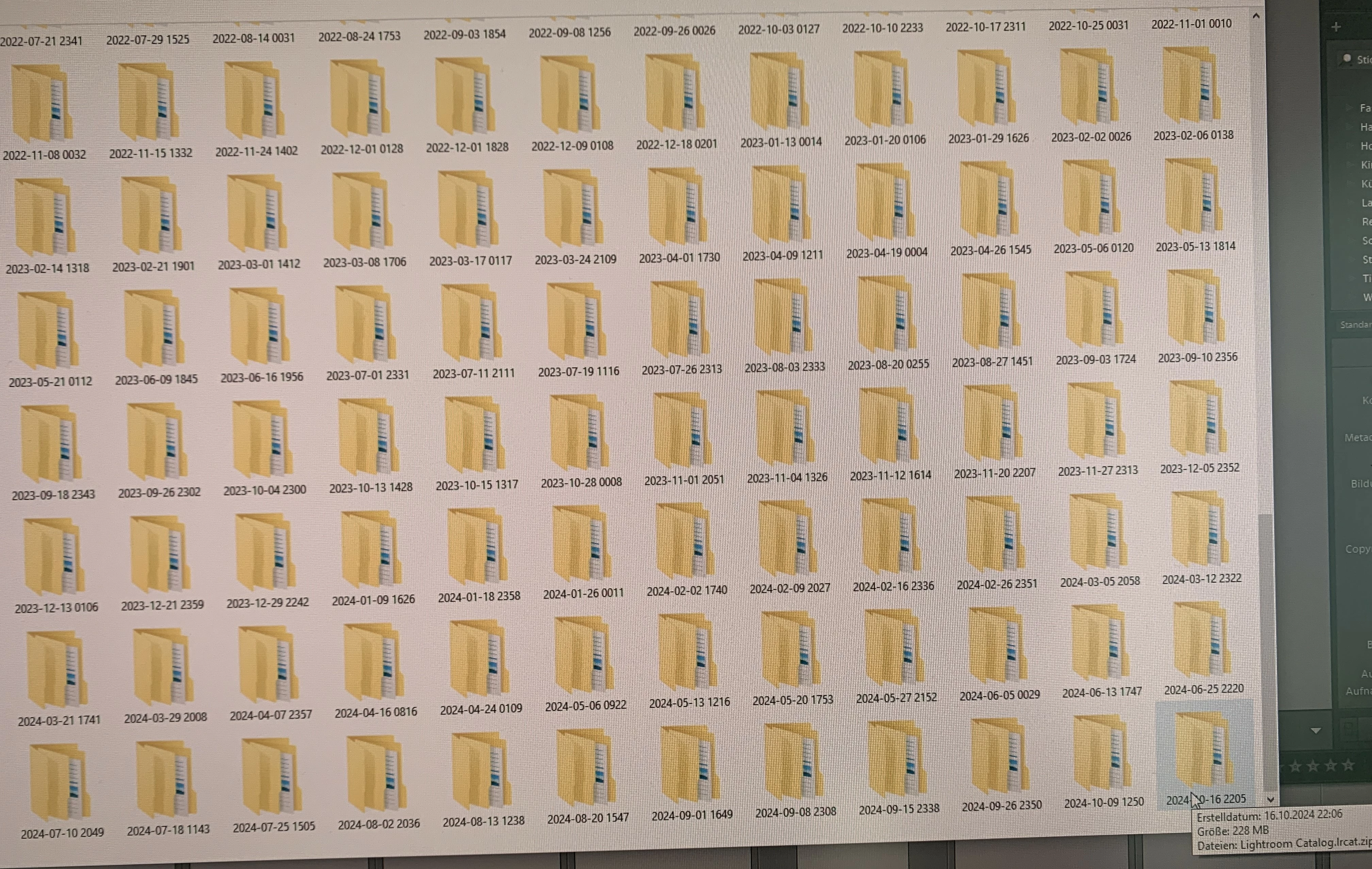

    Your screenclip  { IMG_1196.jpg } appears to be multiple Backups of the catalog/s.  You really don't need to keep that many, and they MUST be on a separate physical hard-drive!
