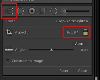

Please give this a try.

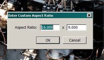

With the original image in the LR Develop module click the Crop tool icon or press the r key to bring that tool up. In the crop tool area in the right hand panel click the double triangle next to the Lock icon and where it says Original then select 16 x 9 from the list that drops down. If you don't see 16 x 9 then select Enter Custom and type in either 16 and 9 or 1920 and 1080 in the respective boxes, width & height respectively.
Here are screen shots.
Crop tool dialog. Crop tool icon and the 16 x 9 drop down in red boxes.
Enter Custom aspect ratio input box.

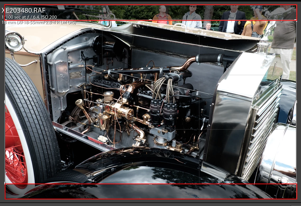

And how the crop tool will crop out part of your image to fit those dimensions.
The areas in red will be removed from view (But they will still be in the original image if you want to Undo the crop after you export it at your 1920 x 1080 dimensions).
You can move the image around inside the area to get exactly what you want in the exported image file.

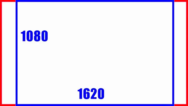

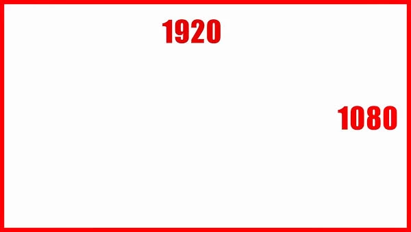

JSM has shown the math, and the answer to "Crop as 16:9" to FILL 1920x1080.
Here are screen-clips to visualize the concept of "Resizing in Lightroom"-
1. The DIMENSIONS you type in the Export Resize boxes define the "Boundaries" for the exported image.
So if you type [w1920 x h1080] then you are defining an empty 'page' that your image must fit within.
2. The image you are exporting must FIT within the Dimensions, and as JSM explains if the image has a different ratio of w:h then it will export at suitable dimensions to FIT.-

It is because the original file you are working with, the one you are exporting, is in the 3:2 ratio.
1620 / 3 = 540  540 x 2 = 1080
If you want the final exported file to be 1920 wide then the height needs to 1280. Again the 3:2 ratio and retain the complete image
Again 3 units wide by 2 units tall 1920 / 3 = 640    640 x 2 = 1280
Your 1920 by 1080 is 16:9 ratio so you would need to Crop the image to that ratio before doing the export.
