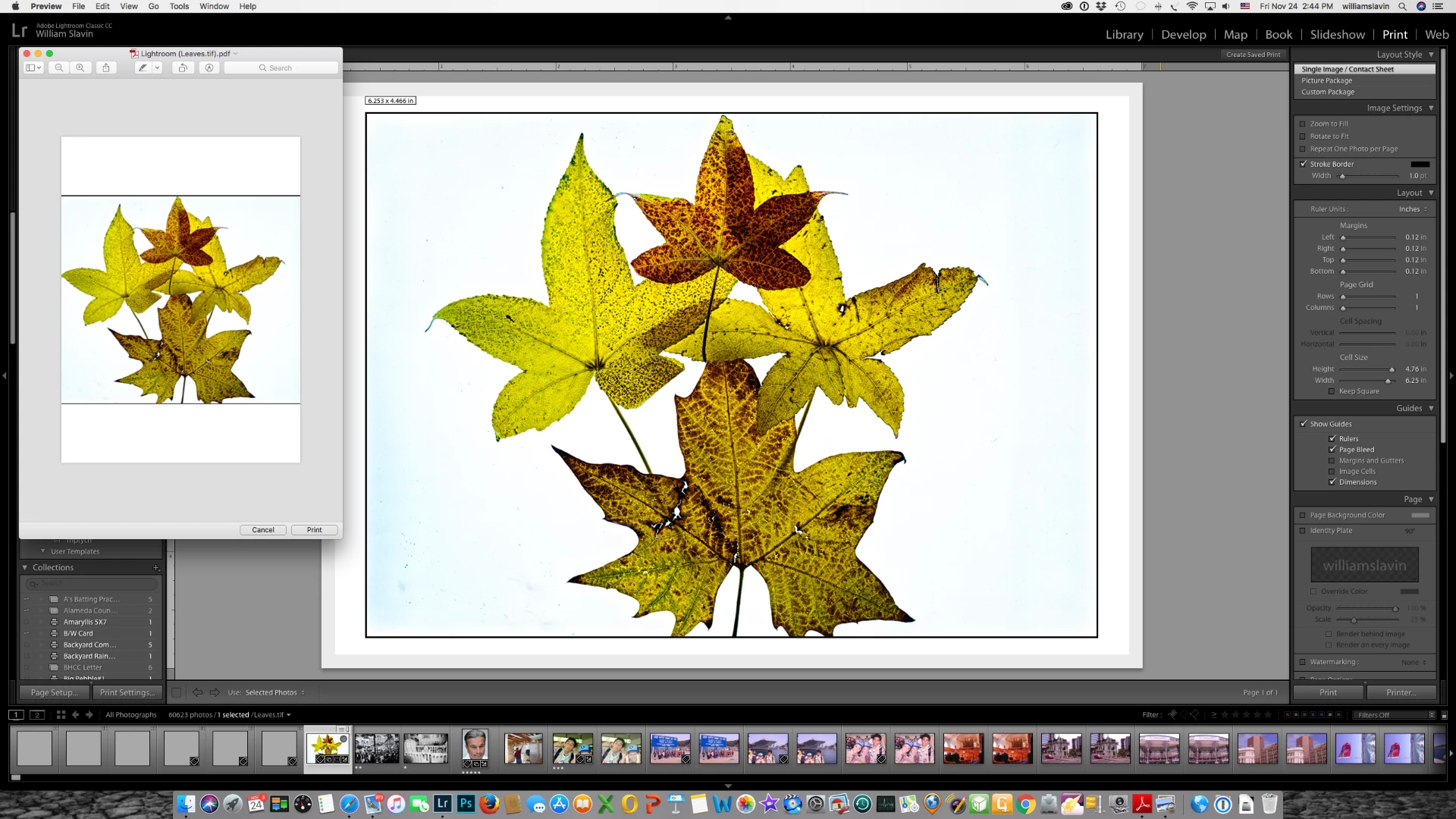

November 24, 2017
Thanks, but I'm still having the problem.
I've been printing for years, but my normal workflow suddenly is not working.
Something has changed.
From the Develop pane, I go to lower left "page Setup" and select Landscape,
Then go to Printer box, lower right, and access Printer Settings, select paper Luster, etc.
Then, when I hit print, it FLIPS TO Portrait!! It does it for every paper size, 5x7, Letter.
It does not do it with saved prints that were printed in the past in landscape.
It is just doing it now!
Here is screen shot, where I selected print to PDF, which has same result.
And... I can't "fool" it by selecting Page Settings as Portrait.  That also prints in Portrait!
The same thing is happening in PS.  When I hit Printer Settings and select landscape, then Print, it flips to Portrait.
If I print to PDF, then I can flip it back to Landscape.
But, something has changed.  Very frustrating.
Any clues?
Thanks for your help!

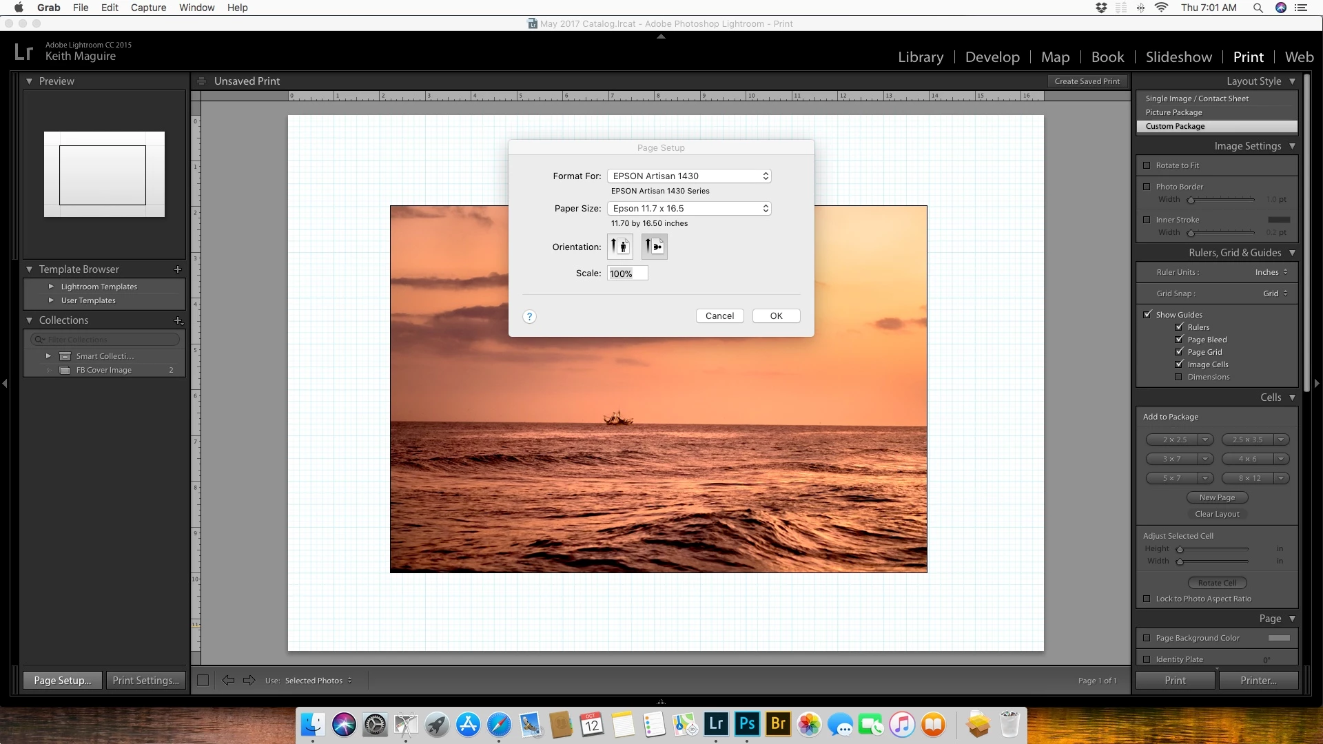

October 12, 2017
The first image is a shot before click print. Notice the orientation in the print dialog shows the horizontal image. The 2nd image is of the dialog immediately after I click print. In this case I clicked print and stopped it. Notice the orientation is back to portrait? What the screen shots do not show is the image is printing on the paper in portrait orientation, not horizontal like I set it to do.
November 14, 2017
I've just wasted two 13x19 sheets trying to print exactly what you show. If you can discover the correct settings in all the dialogs I'd sure love to know. Thanks!
