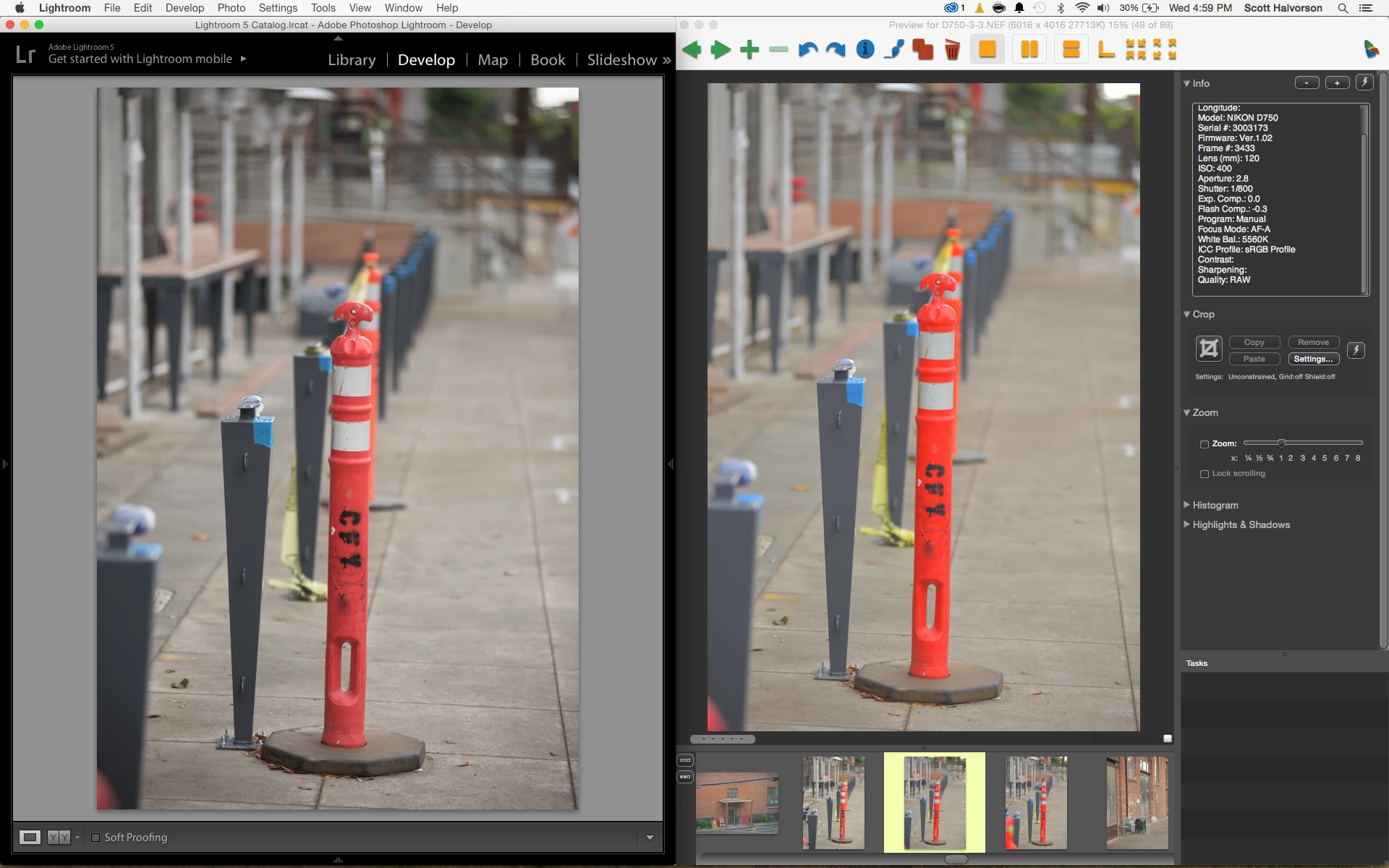

June 11, 2015
Hi Everyone.
I just found this thread and wanted to share my experience. I have spent the last days tweeking my in camera settings for my D750. My wife and I shoot with both the D700 and the D750. We love the look of the D700 images and we felt like the D750 images were flat, muddy, and un saturated compared to the D700. We use Lightroom to view and develop our images. I changed the Fine tune exposure, and the Set Picture Control attributes in camera until our images looked similar enough in Lightroom. We went outside and did some street shooting to test our settings in the real world and when we came home we dug in a little deeper. After viewing the raw images in both Lightroom and Photo Mechanic we noticed a vast difference in the image quality (as pictured below). We then checked the D700 images in both programs and found a vastly reduced difference.
The bottom line is this, Lightroom is changing the appearance of my RAW files and I have no idea how to fix it. If anyone has any answers to this issue, please help.
This is a screen shot of the two D750 RAW images, untouched, no presets applied. Keep in mind I intentionally upped the Saturation in camera to make it look right in Lightroom.
This is a screenshot of the D700 Raw images in both programs.
