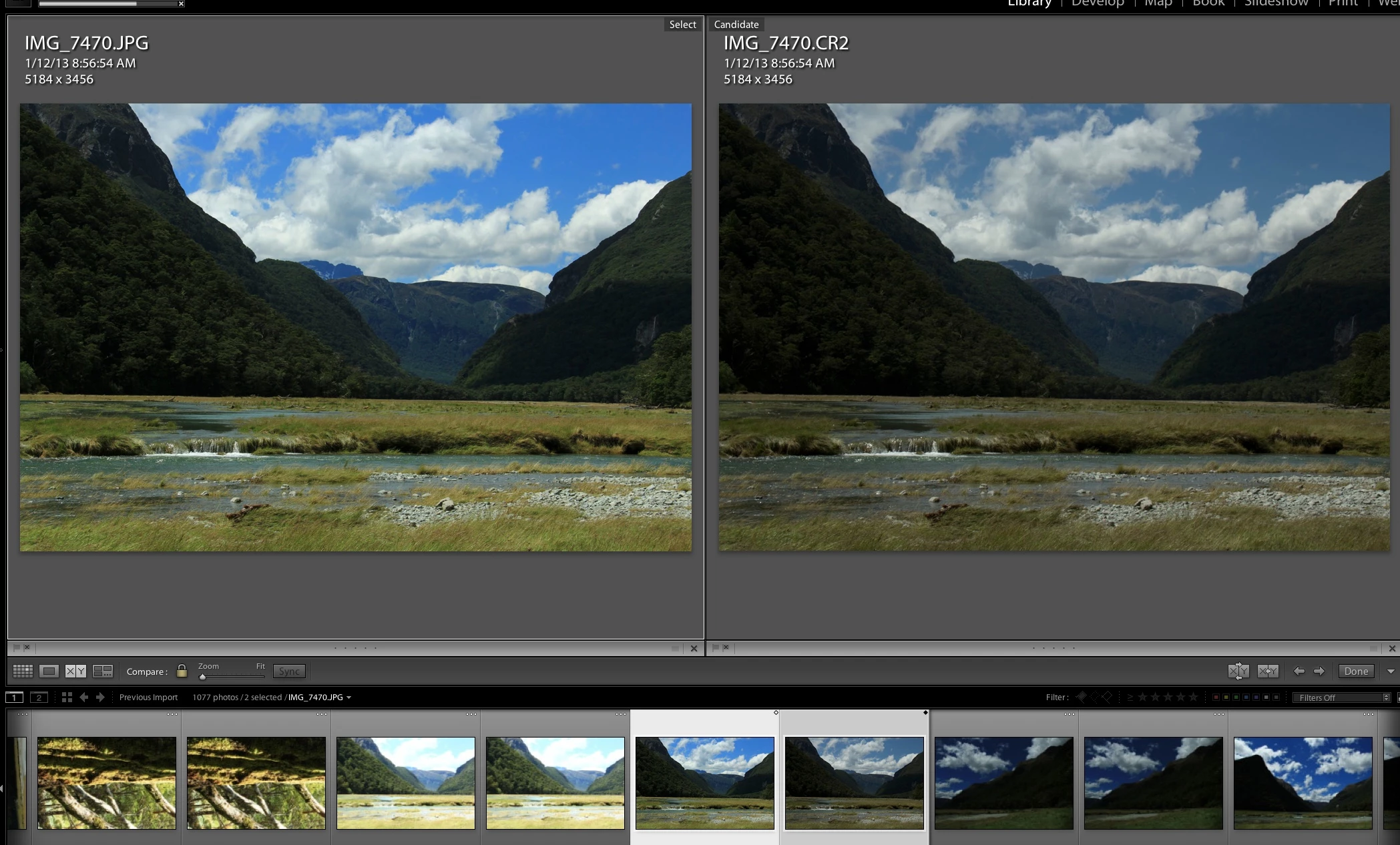

January 20, 2013
I just saw your posting after having the same problem and I think I have a solution/work around for you.  I had a chance to work with Mike Langford (http://mikelangford.co.nz/htm/geo.htm) last week in NZ and he recommends capturing your images in both RAW and JPG.  I am using my Canon EOS 60D and can select the "PictureStyle" option in the menu that allows adjustment of sharpness, contrast, saturation and color tone right in the camera.  These only affect the JPG image so I can see exactly what the image will look like while I am on location.  Mike says that this gives you the chance to make (mostly) color and contrast changes to get the image you want/see on the spot.  When I import them into LR however I make sure that my preferences are set to "Treat JPG files as seperate photos".  After downloading the images you have them side by side.  If you open the RAW image, LR strips the preview data and gives you that image you dont like, however the JPG will open with all the in-camera adjustments intact!  This is fantastic for reference so that you can make the LR adjustements to your RAW image if you want or just use the JPG as is.  Here is an screen grab of a shot I took in NZ with the RAW and JPG side by side as LR displays them.  You can see the difference in the saturation and brightness/contrast.  Hope this helps...
areohbee
January 21, 2013
I compared raw to jpeg for the first year or two using Lightroom. Once you can get better results, consistently, using Lightroom, than your camera can do, consider shooting raw-only and ignoring the jpeg. At that point, you may also be ready to change your camera settings to always shoot with a reduced contrast profile (consider boosted saturation), since the goal of the jpeg will be changed to facilitate assessment of inherent color and detail in shadows and/or highlights... - *not* to have a good looking picture, which you know you'll be able to create, later...
PS - if you switch the right-hand shot to 'Camera Landscape', then make adjustments:
exposure: +.3
whites: +15
blacks: -10
highlights: -20
shadows: +20
clarity: +5
then how do they compare ;-)
Disclaimer: just "wingin' it" on the proposed adjustments...
