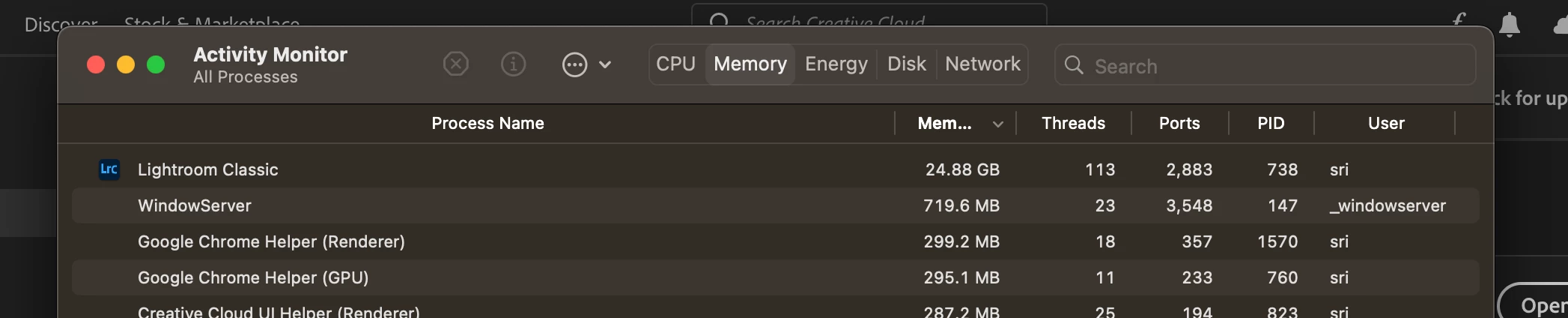

Lightroom classic 11.5 makes so much fan noise when previewing few presets for 30 seconds or more on a raw file and the cpu usage is more than 650%. Machine gets very slow and kind of stuck which makes it impossible to edit photos. I rolled back to LC 11.4 and i don't have this issue. Looks like its with the newer version. Please fix this issue.

Updated to lightroom 12.0.1 and its very worse now. Even while working on images it makes so much fan noise and cpu heat is 97%c I takes lot of memory and makes my machine very slow. Unable to use this sfotware. I'm going to cancel my subscription if the issue is not fixed. No updates yet on my above previous posts above

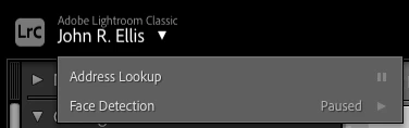

1. Is Face Recognition running? Click on the identity plate in the upper-left corner to check:
