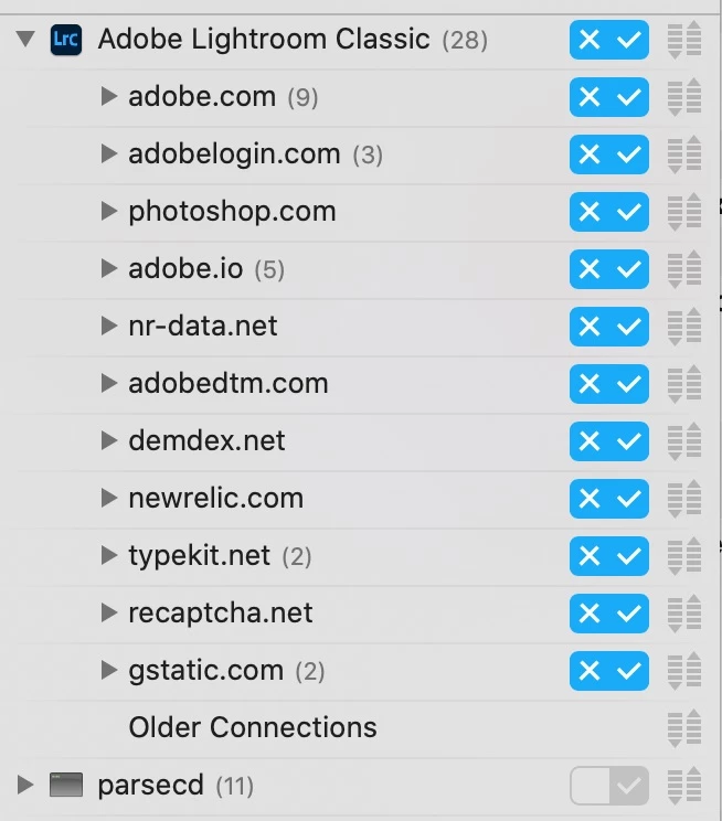

Reviewing the console logs, I can see that LRC is establishing network connections during the 1-2 second startup period, and then fails with "UNIX error exception: 17". I note that Little Snitch (when enabled) was showing successful connections to various Adobe-related domains -- see attached screenshot.

One curious thing I am investigating is: Little Snitch can do network packet capture of nominated processes. I set it to capture LRC, started LRC, and checked the capture file when it terminated -- there were no network packets sent. I checked packet capture with another app (Trello) to confirm that Little Snitch packet capture was working; now I am going to investigate why LRC appears not to be doing network traffic, which is inconsistent with the diagnostic messages in the console. It might be that LRC uses a proxy for its, network traffic, I don't know at this point.

  • I opened the capture file with Wireshark and confirmed a total of 38 packets had been exchanged with two remote IP's:
    • 192.147.130.166 (crlog-crcn.adobe.com)
    • 3.220.9.154 (ec2-3-220-9-154.compute-1.amazonaws.com)
  • I reviewed the console log and confirmed the capture traffic was consistent with the console errors - LRC is failing due to a "phone-home" communications error during startup. The network connection is not being blocked, so the problem appears to be between LRC & the Adobe servers.
