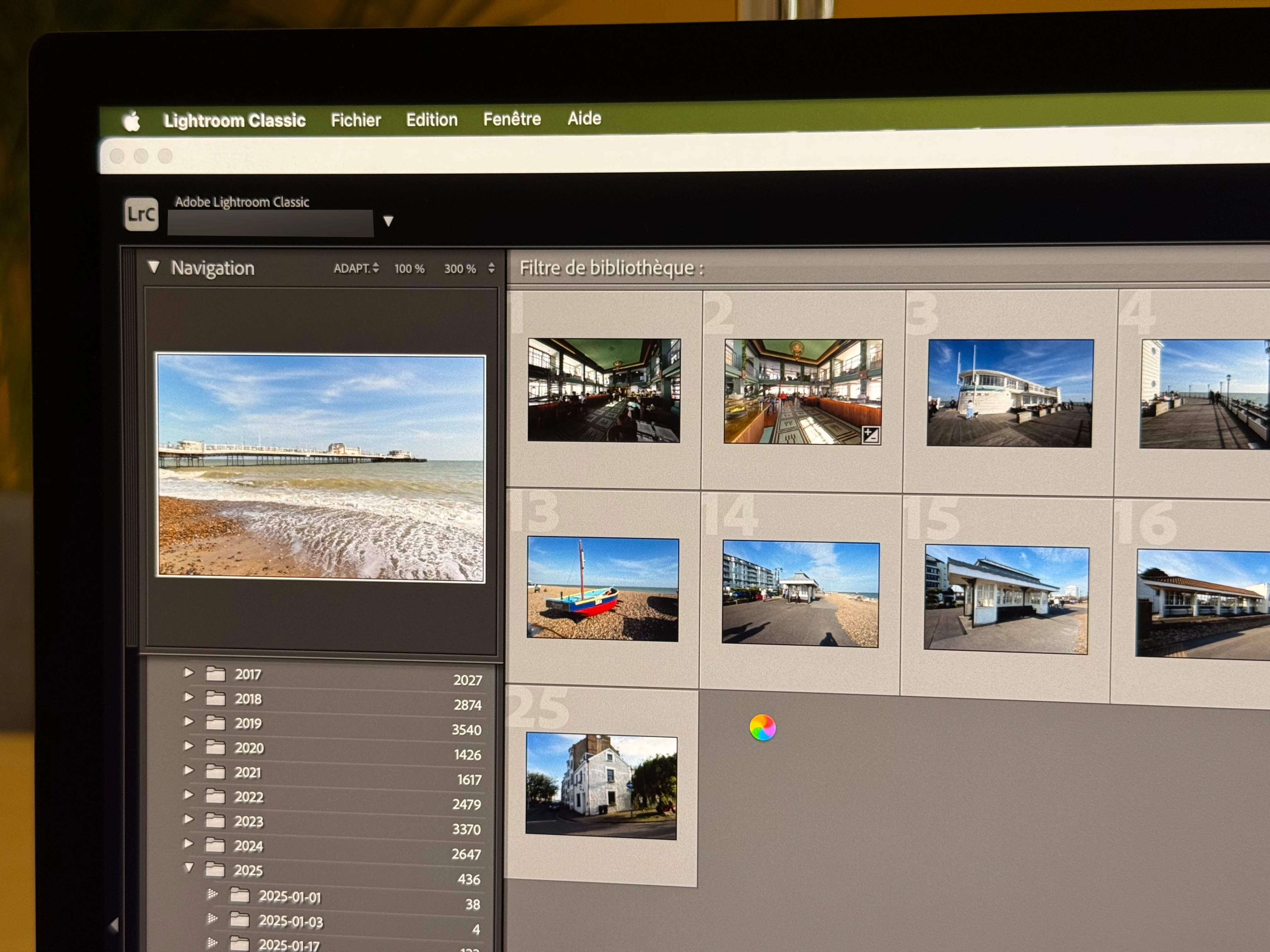

I've had this problem for a few months.  On my Mac Pro 2019 (Intel Mac running Mac OS Sequoia 15.3), Lightroom Classic 14.2 starts normally and works for a few seconds.  Then it goes into beach ball.  It stays on top of other applications and is completely frozen for about 30 seconds.  Eventually it unfreezes and I can continue my work.  This problem happens systematically, regardless of whether a camera is plugged in, computer freshly restarted, etc.

Hi Golding, when the beach ball starts turning, no operations are running.  The beach ball starts turning about seven seconds after Lightroom becomes ready for use.  So I start Lightroom, I can use it for about seven seconds (just browsing or even doing nothing), then the beach ball runs for about 30 seconds (Lightroom frozen).  Suddenly after 30-40 seconds it unfreezes and I can resume work.
