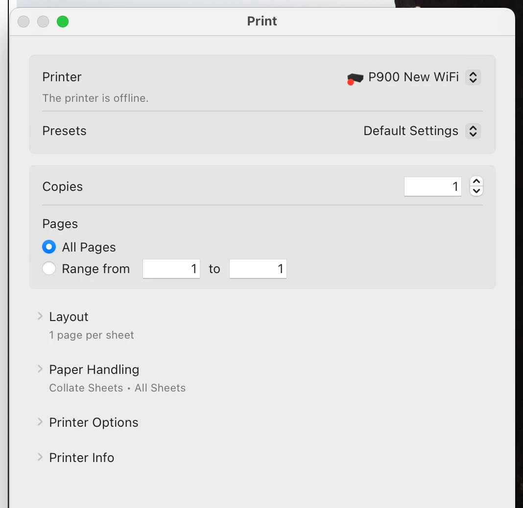

    I’m running a printing workshop and had to setup a group of mac and windows computers to print on my Epson P900. The printer is using the latest firmware. All the Tahoe computers failed, everything else passed, here is what happened.
    For each computer, we went to the Epson support page and downloaded the driver for their operating system. None of the computers had connected to the P900 before, so there were no old drivers present. Most of the Mac computers were running Tahoe 26.6.1 or 26.6.2, some were on Sequoia, PC’s were on Win11.
    We ran the driver installers without issue. For all the Mac’s, we removed the AirPrint printers and added the Epson versions all went well.
    We opened the Print module in Lightroom and started to setup a print. As soon as I selected Page Setup and chose the Epson P900, something was sent to the printer and it started operating. The printer raises an error on its screen asking for the roll paper adapter to be added. The error can be cleared down and the printer settles down.
    We then finish setting up the print layout, paper size and source selections, media type etc and finally press print. Nothing happens. There is a job in the print queue but the printer doesn't print. I tried powering off the printer and re-starting to no avail.
    Every one of the Tahoe computers does exactly the same. The sequoia Macs and PC’s work as expected.
    I saw someone post something very similar but there was no resolution. Can anyone help?

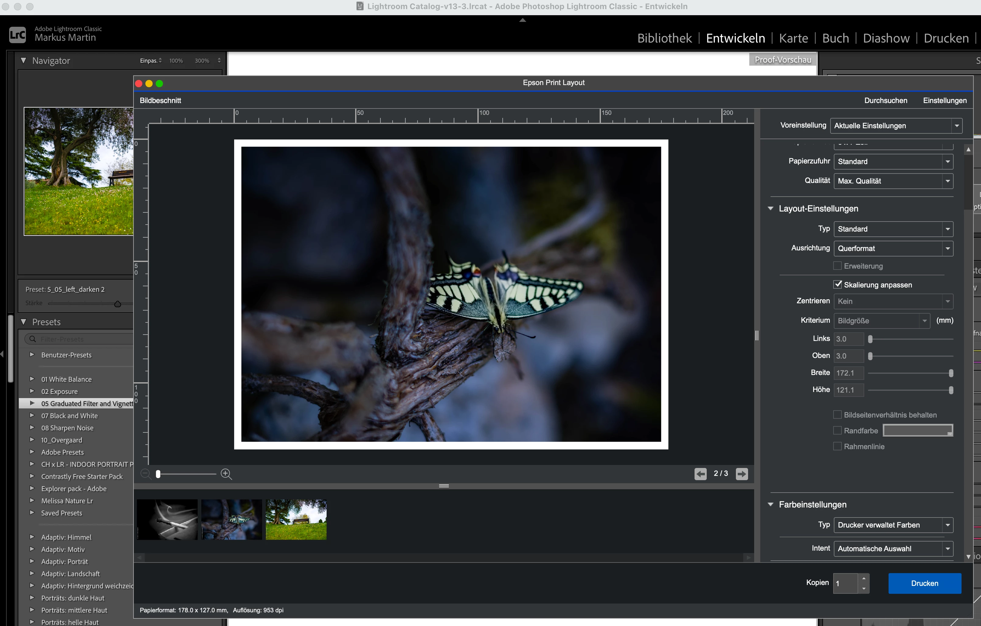

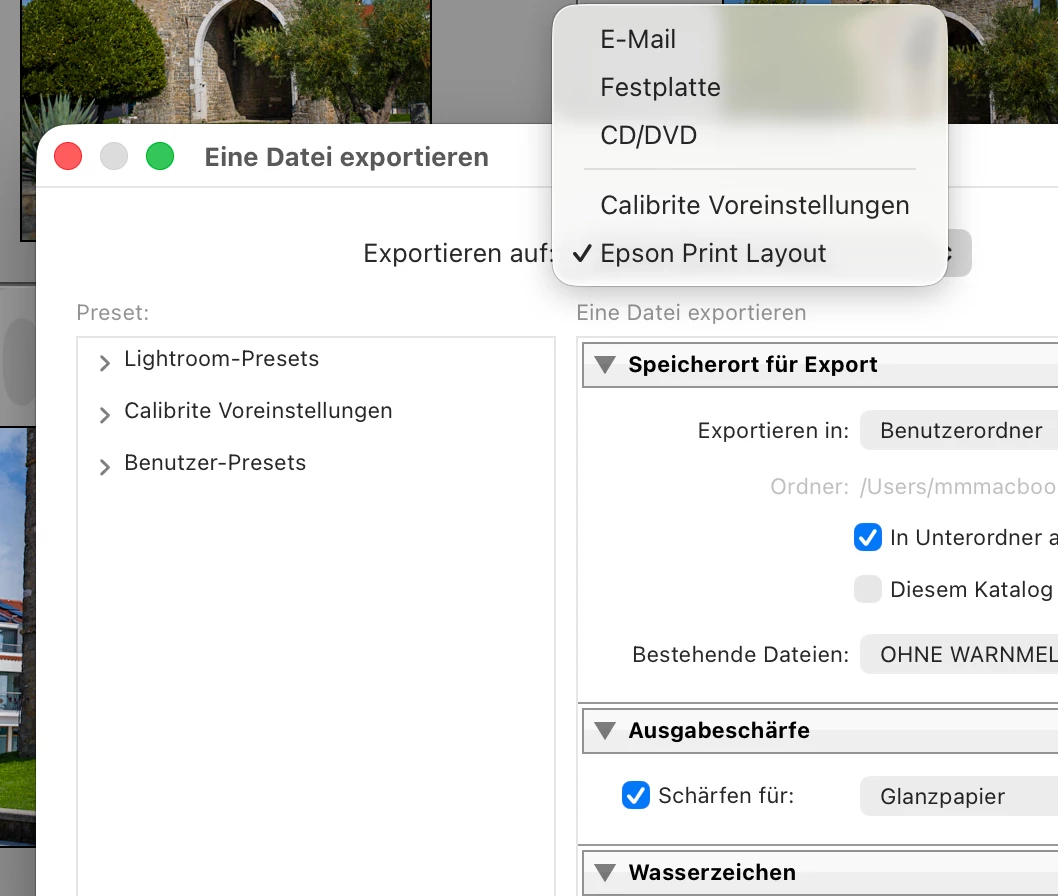

    Possible Workaround for Fine Art Printing Issues with Adobe Lightroom on macOS Tahoe
    I experienced what appears to be exactly the same frustrating issues with my Fine Art photo printer under macOS Tahoe.
    After spending countless hours cleaning up the Library, removing and reinstalling printer drivers, and trying various installations and uninstalls, I eventually gave up trying to restore my usual printing workflow directly from Adobe Lightroom.
    However, I have now found a working solution: Epson's "Epson Print Layout" application.
    Installing the app and, in particular, integrating it into Adobe Lightroom is a little tricky, but it can be done with some patience.
    I can now use Lightroom's Export function (TIFF) to select "Epson Print Layout" and send my images directly to the Epson application.
    From there, Fine Art printing works perfectly again. Paper types, print settings, and all the other essential parameters are once again available and can be adjusted as needed.
    For me, this is currently a reliable alternative to my previous printing workflow.
    Perhaps this workaround will help others experiencing similar problems – at least until the printing issues under macOS Tahoe are resolved.
    I've also attached three screenshots to illustrate the workflow.
    Good luck, and best regards,
    Markus Martin
