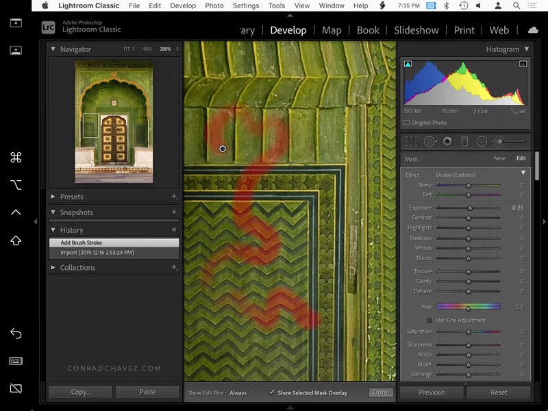

Conrad_C
Feb 23, 2021 3:55 AM UTC
Nothing is standing in your way to use Sidecar. It’s already been working for some time. If you set up Sidecar properly, it will work with no problem.
Have you done these steps already?
  • Set up Sidecar to operate as a separate display, not mirrored. If it’s mirroring, click the Sidecar icon in the menu bar and choose Use As Separate Display.
  • Use the Displays system preference, Arrangement tab, to tell the Mac which side the iPad is on.
  • Move the Lightroom Classic window off the Mac display and onto the iPad display, as is normal between any two displays connected to the same Mac, with or without Sidecar.
If you have done all of those things, it should work.
Below is a picture of Lightroom Classic on the display of my old 2017 iPad Pro through Sidecar in macOS 10.15.7. You can see the blue Sidecar icon in the menu bar, and also the Sidecar sidebar on the left. I painted the red Adjustment Brush overlay in Lightroom Classic using the Apple Pencil on the iPad. You can see that I was able to vary the weight of the Adjustment Brush stroke in Lightroom Classic, by using Apple Pencil pressure sensitivity on the iPad display.
