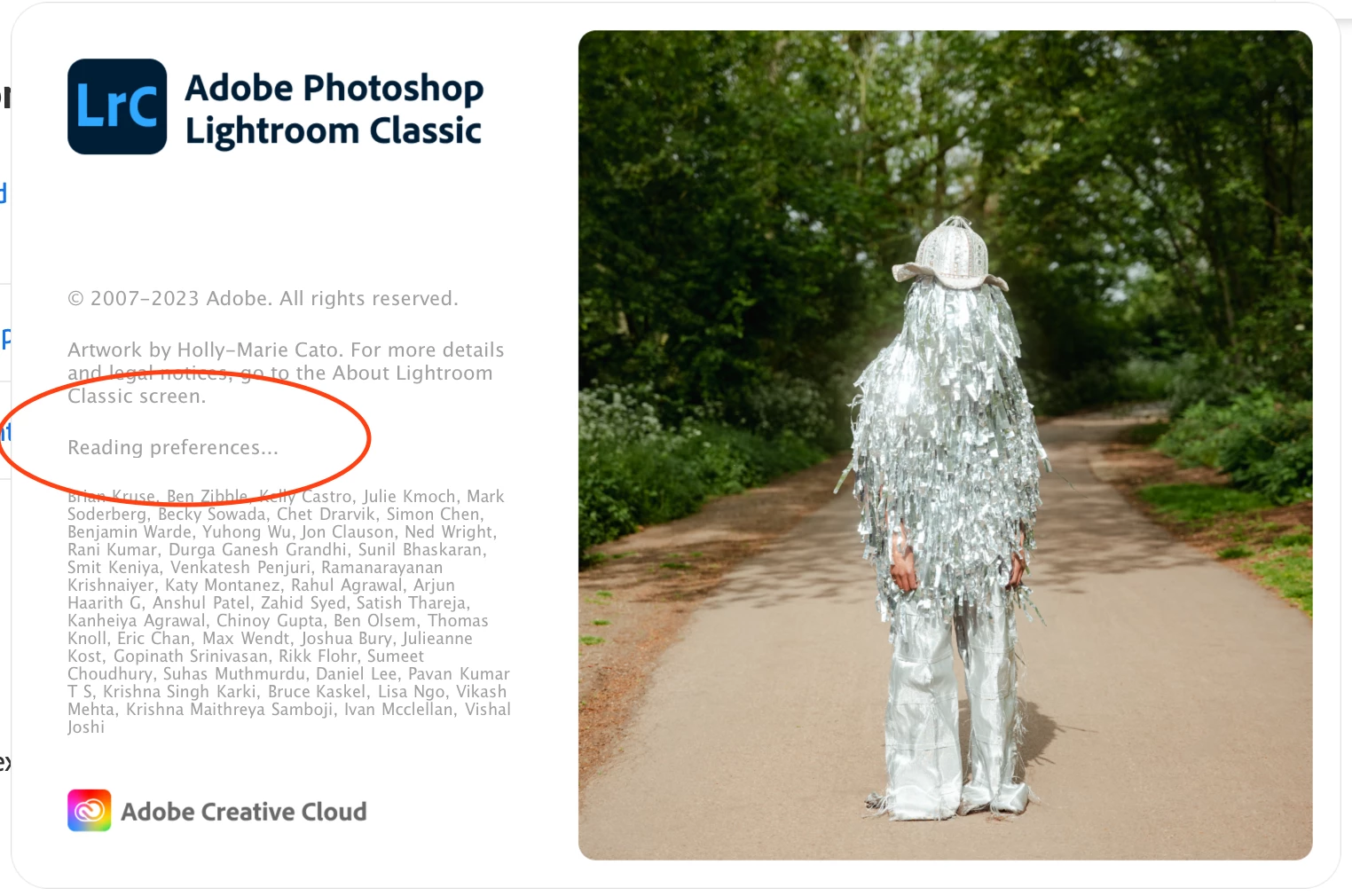

Lightroom Classic and Lightroom won't open on my macbook pro
Lightroom Classic just stays on the artwork that is displayed while loading.
Seems to get stuck on reading preferences.
Lightroom  doesn't open up either but has an error message that says:
AgImageIOInit.init: failed to initialize Camera Raw: initializing Camera Raw: dng_error_unknown
All other Adobe apps are working so I have no idea what's going on with these.

Stuck at reading preferences. Have you considered resetting the LrCc preferences file? It might be corrupt. Carefully read:
AnthonyB Media
Feb 3, 2024 2:18 AM UTC
Unfortunately, I've tried that many times with no luck 😕😕
