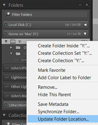

I think it would be simpler if you changed your catalog to refer to the new locations of the photos at E:\Photo.  To do that:
1. In LR's Folders panel, find the section for the P drive.
2. Right-click a top-level folder in that section and do Show Parent Folder.  Repeat that until P: is showing as the top-level folder in that section.
3. Right-click P: and do Update Folder Location; select E:\Photo as the new location.
This is what it looks like (with a Y drive instead of P):
