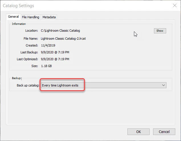

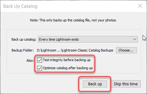

"Although activated LR doesn't create a backup of the catalog whenever the program is closed."
Under the LrC Edit menu makes sure the below setting is selected. When LrC is closed you should see the below popup. Instruct your user to click on 'Backup' as shown in the 2nd screenshot below. Also make sure the two backup options for imtergity check and optimization are checked. The backup will take a little longer, but may help prevent the corruption. If the catalog is corrupted the integrity check will detect that and provide a warning.
If the backup still isn't being created you may have a user permissions issue concernng the target location for the Backup Folder. Where are the backups being saved?
