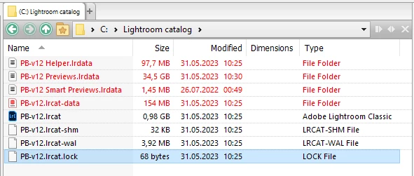

August 14, 2023
When LrC is running, there is a lock file present in the folder that contains the catalog.
The lock file prevents other users from accessing the catalog.
It is normally deleted when you exit the program, but if it crashes or doesn't close down properly (for instance power failure), the lock file might not get deleted, and you'll get that error message.
To fix this, you have to delete it manually.
With the Finder, go to the folder that contains your Lr catalog. (usually inside the Pictures folder)
Delete the file with the extension .lrcat.lock  Do not delete anything else.
Now launch LrC.
Risto VAuthor
August 15, 2023
Thank You! I did remove the lock file, but it still says the same thing, so
I did not help.
Now what can I do?
dj_paige
August 16, 2023
quote
Thank You! I did remove the lock file, but it still says the same thing, soI did not help.Now what can I do?
By @Risto V
USING YOUR OPERATING SYSTEM
Find all of your catalog files on all of your local disk(s), using your operating system's search feature. These are files whose name ends with .LRCAT (might be lower case). Go to the folder that each catalog file is stored in and make sure the .LOCK file (if it exists) is deleted from each of these folders. Do not delete anything else.
Once you have fixed this, you need to get serious and combine all of your catalogs into a single catalog (unless you have very good reasons not to do so).
