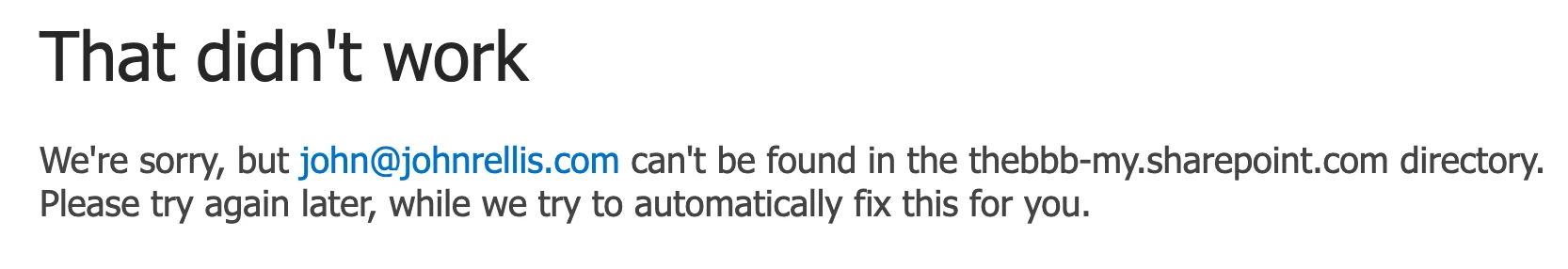

It appears that download link doesn't allow for public access:
Maybe use a free account at Dropbox or Google Drive, or use free WeTransfer to send it to my tech-support email address.

Here's a share link to view a short clip of the footage:
https://thebbb-my.sharepoint.com/:v:/g/personal/brian_evancic_thebbb_org/Edjk9oHuK_hIq4uaUJ9rNP4B9We8AbyDWutNsXk-xVPoQQ?e=S7OuZR
