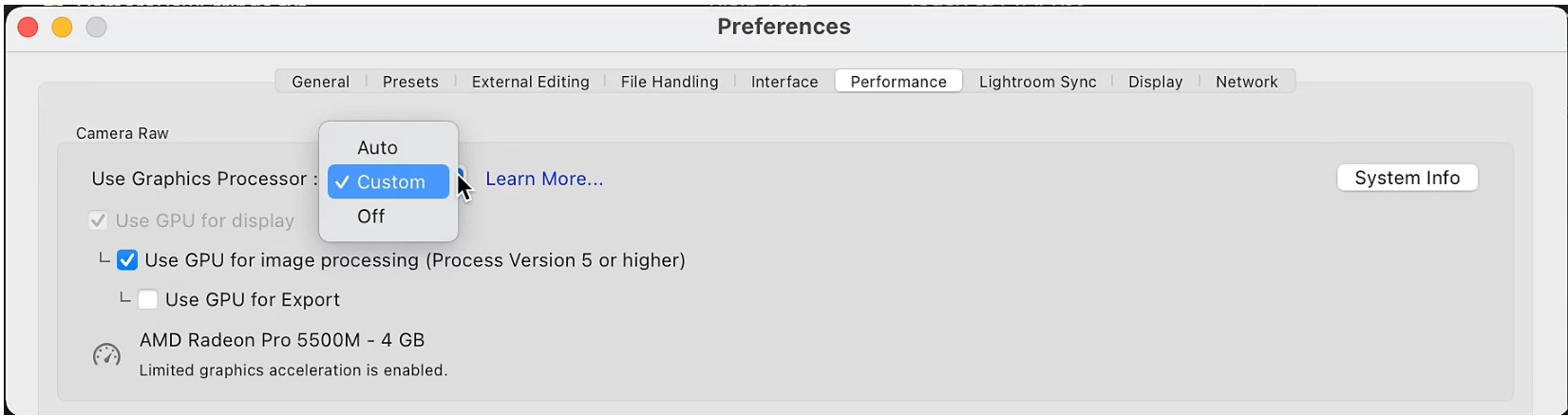

    Hi ​@wegen ​@elledo
    Sorry to hear you're experiencing this issue. Could you please help us with a few additional details?
    • Please share your System Info (available from the Help menu).
    • Let us know where you are exporting the file. Does the export also get stuck when exporting a local file to your Desktop?
    • ​@elledo please confirm if export is working as expected on 15.2.1
    • Please try changing the GPU Usage setting in Preferences. If it is set to Auto, turn GPU usage Off and check whether the issue persists.
    If the problem persists, please try resetting Lightroom preferences manually after backing up your settings. The steps are available here: https://helpx.adobe.com/lightroom-classic/help/reset-preferences.html
    Once you've tried the above, please let us know the results so we can continue troubleshooting.
    Thanks, Srishti Bali | Community & Engagement Strategist, Digital Imaging | Adobe

    Otherwise, I turned GPU usage off, I reset Lightroom preferences, even uninstalled and installed a fresh version without preferences, but the issue persisted. Finally, I downgraded to 15.2.1 to export my work.
