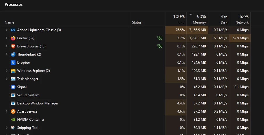

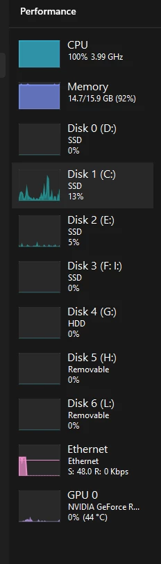

Little Update, I've installed more DDR RAM in my machine and from 16 to 32, it should also be a more powerful RAM than the old one.
The way I've figured the issue, was by opening up the task manager during the extremely slow export and check the performance tap, my RAM was almost always up at 98/99 Percent usage - with the double amount now it mostly stays under 70 Percent.
In any case, that was the solution for my issue and I hope it'll help someone in the future.

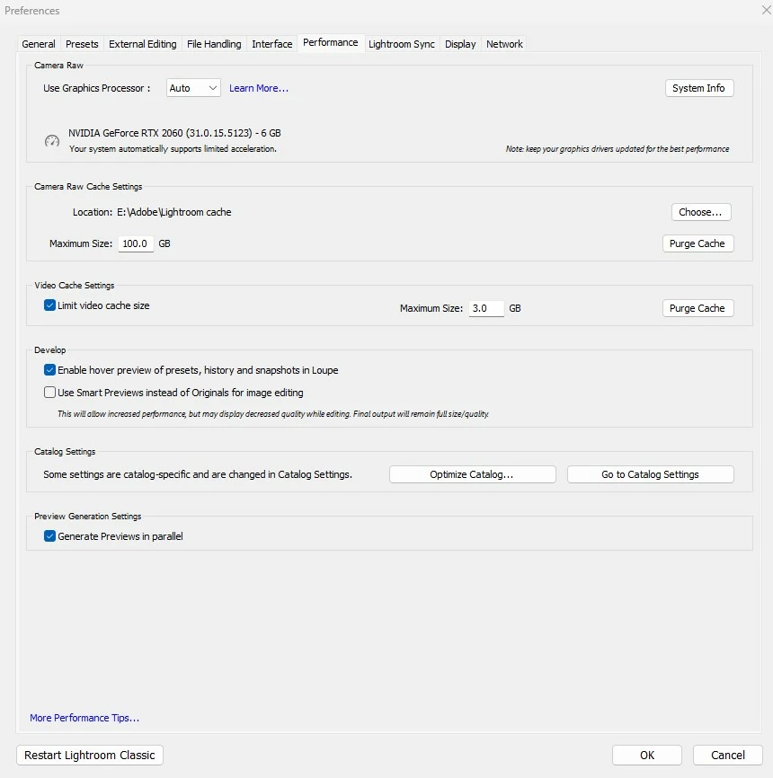

GoldingD
January 30, 2024

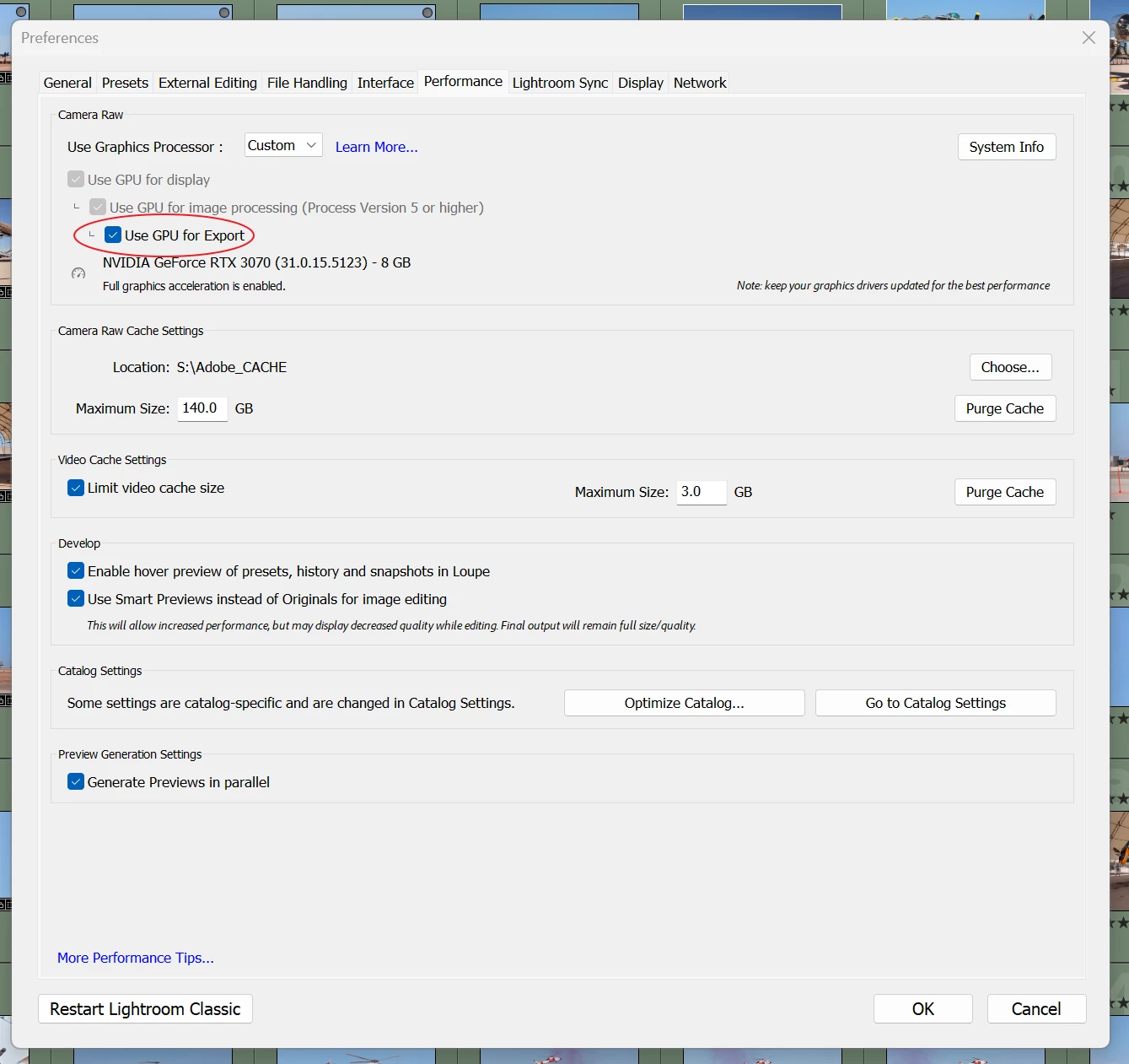

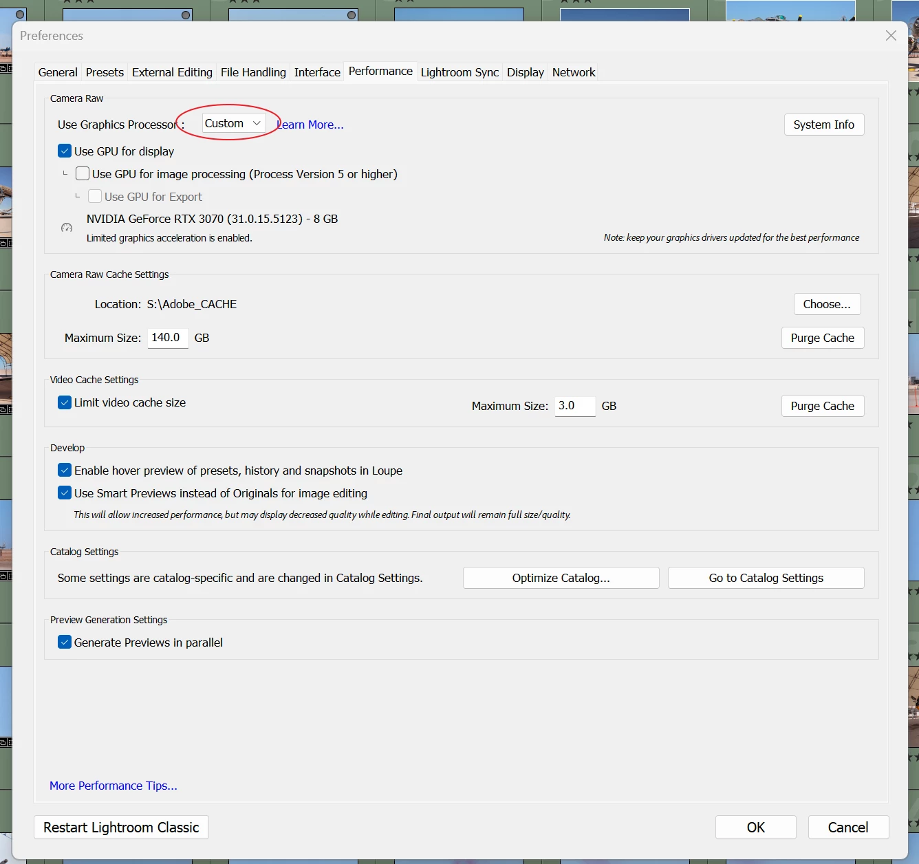

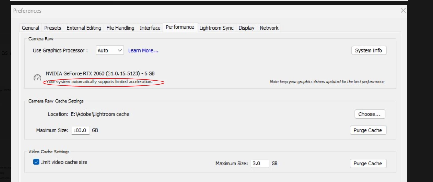

From your screenshots, I am wondering about this one
Is the NVIDIA RTX 2060 with 6 GB that old that it cannot support full acceleration, and is it not supporting export

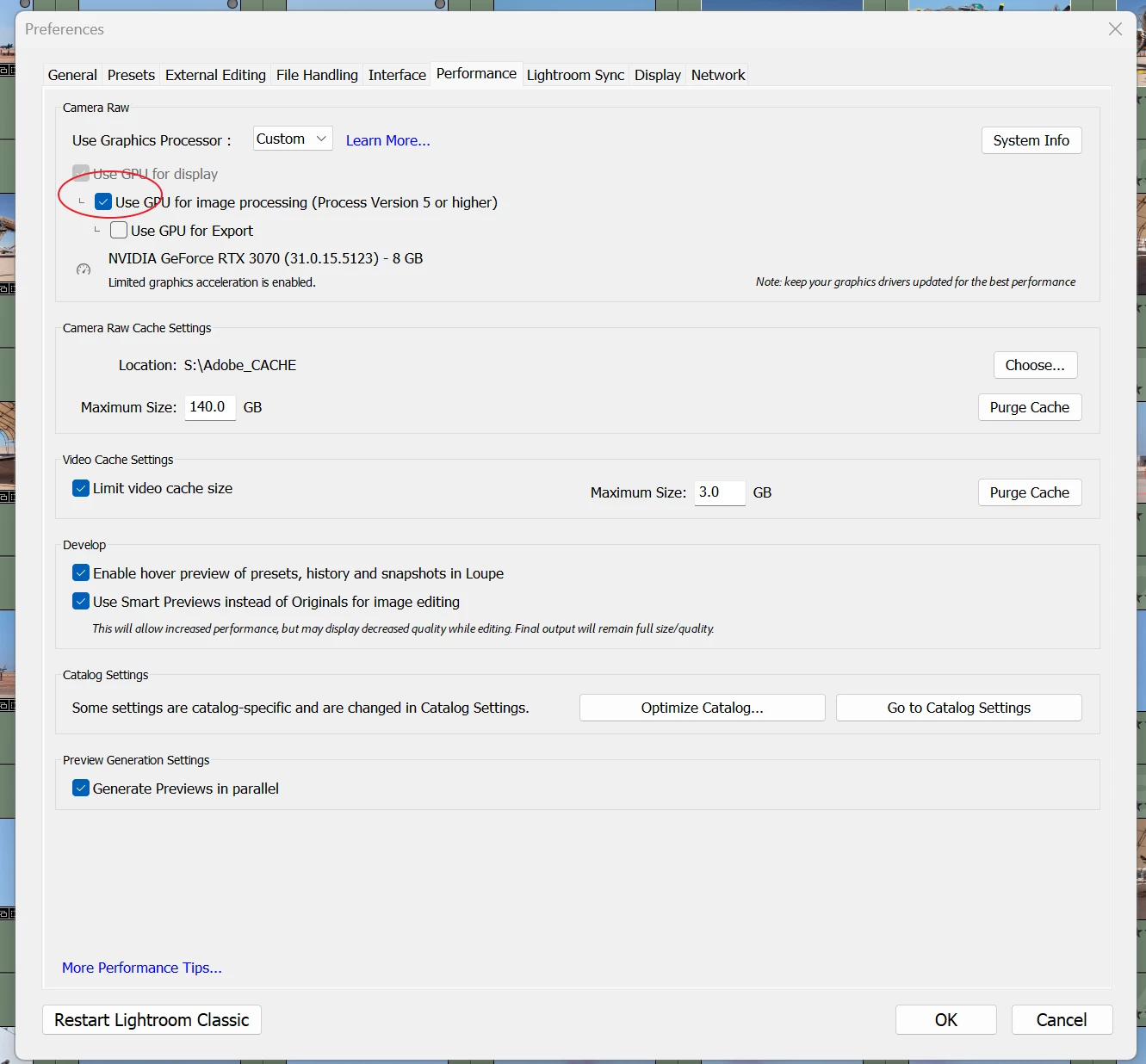

Following are samples from my rig. Perhaps you can attempt to change the Use Graphics Processor setting from Auto, to Custom, and see if you can accomplish the following selections.
 As shown above, change to Custom. Very likely the USe GPU for display will already be checked. Highly likely the Use GPU for image processing, and the Use GPU for Export, will not be checked (yet), And the latter will be grayed out. Note that you will not be able to directly click on the last option USe GPU for Export just yet.
As shown in the above, check Use GPU for image processing
And, crossing fingers, click on that last one, Use GPU for Export.
I do not remember, if after clicking Ok, if you will need to restart LrC.
And I do not know, if after accomplishing the above, if reverting to Auto, would then behave better (if one wants to bother)
P.S. their is a method involving deleting a file or two to force LrC to reconsider the GPU at startup. I do not have a link for you at this time. Perhaps another member has that????

GoldingD
January 28, 2024
Go back into /preferences/performance/
For the use graphics processor section, select Custom again
Then click on that 2nd option"Use GPU for Image Processing"
And then , hopefully the third option will then not be grayed out, and click on that last option "Us GPU for Export"
You may need to restart LrC
What happens?

Can you share three four  pieces of information.

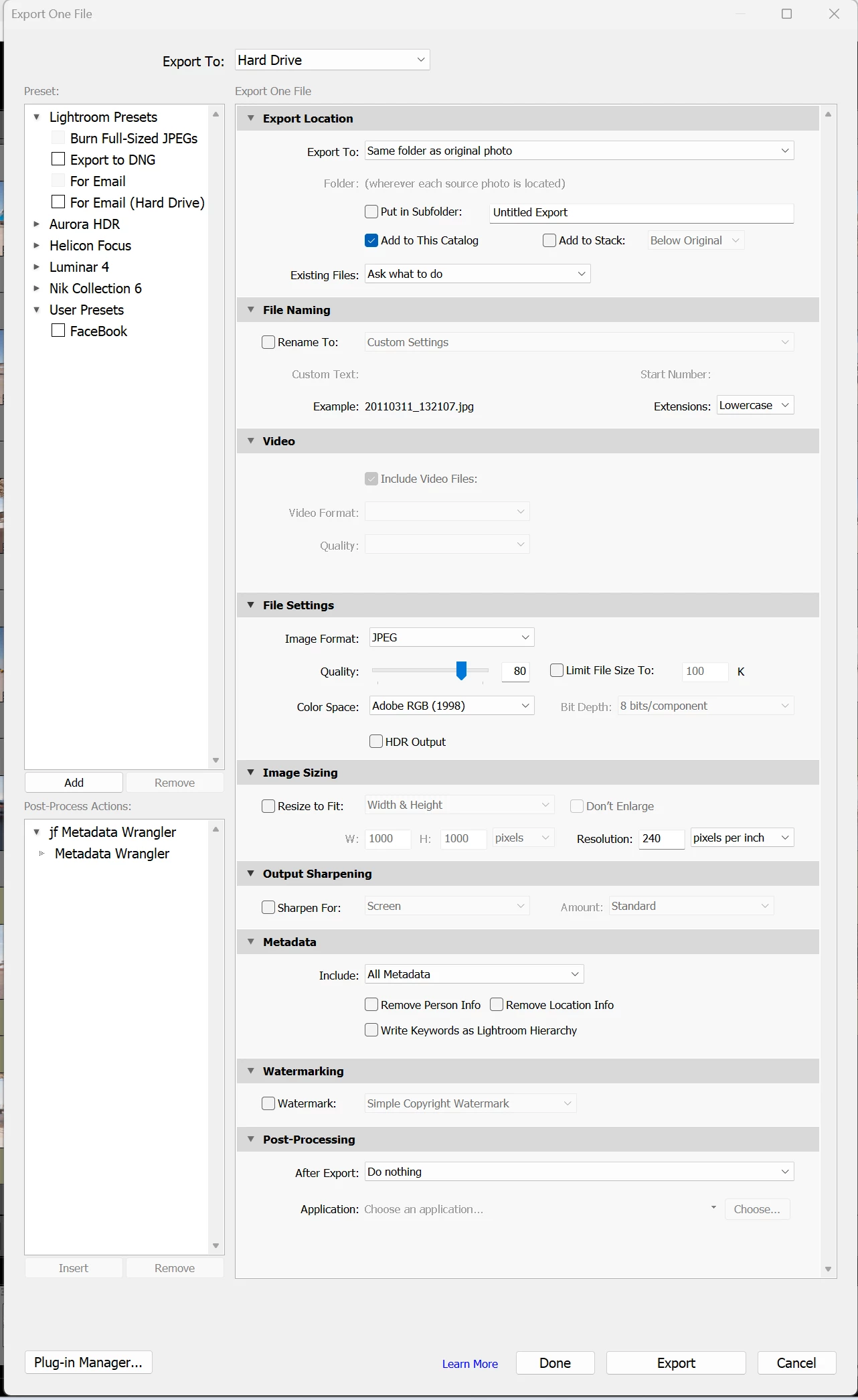

1. Your Export Screen (incidentally your stated " export settings are at auto" I have no idea where auto comes from, perhaps when you post this it will be clarified.)

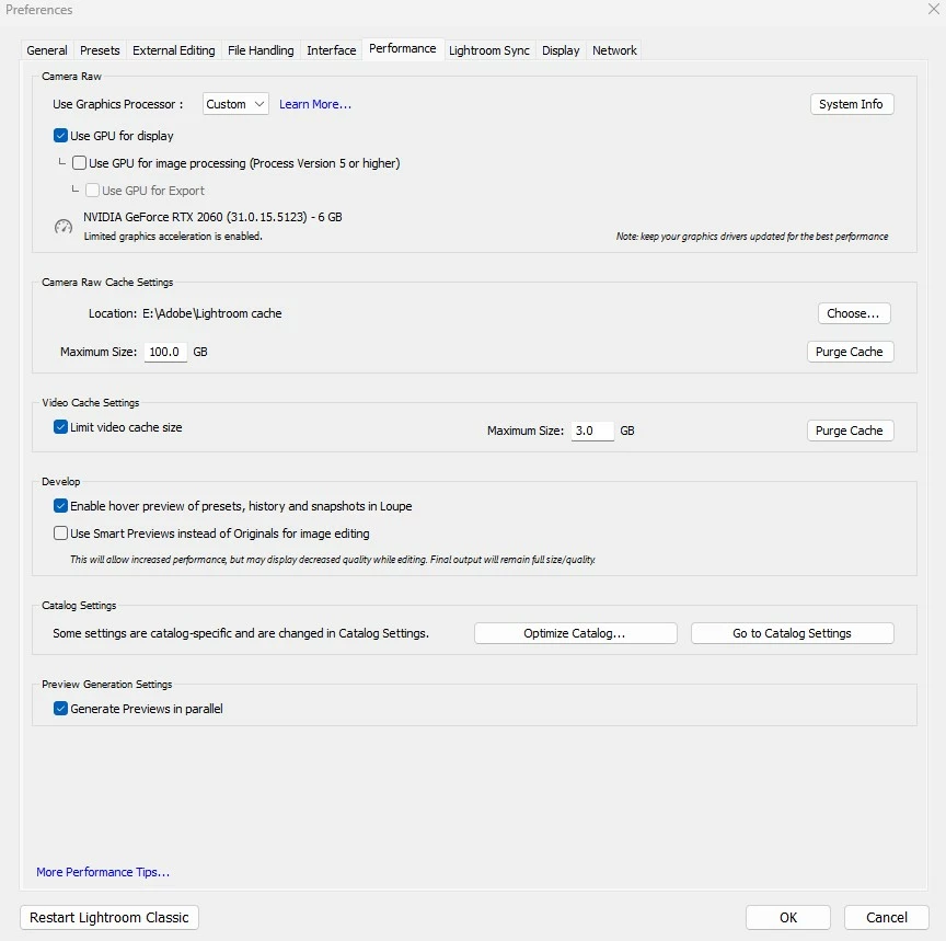

2. Your /preferences/performance /   screen
 example deleted now that author has posted, this to save scroll space.

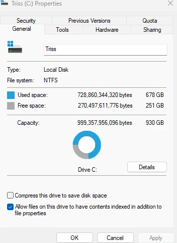

3. And as for where your catalog is located, how much free space in %
63%

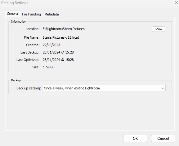

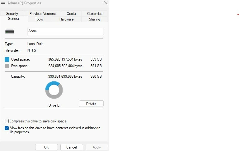

Danny Stein
January 28, 2024
Dear GoldingD,
Thank you for your response. Here are the details:
^ This is the drive where the cataloge is, I tried it at the same drive where Lightroom is installed but it didnt solve the Issue.  I had the Raw files (CR3) also in both drives, changed the location of them to see it if changes anything. But it didn't.
^ This is the drive where lightroom classic is installed, as with the catalog, I tried installing it on the other drive as well, but it didn't change the outcome.
I tried this export prefs as well as the ones below, also tried to increase the cache, but it doesn't seem to make a difference.
Thank you for any ideas and takes on this.
