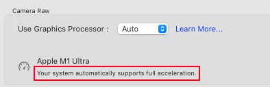

Open the LrC Performance Preference tab and check that the GPU is set to Auto AND that the system is actually using 'Full Acceleration'. I've attached a screenshot indicating where to look. Report back with what you find.
July 10, 2023
Thank you but it is set this way from the beginning, what else could it be?

Lr Classic, Lr Desktop and Camera raw all test the GPU for compatibility when the applications are launched. Occassionally, the test fails with the result that the GPU is set back to Off or more usually 'Limited Acceleration'. Since GPU accelerated export depends on 'Full Acceleration', then anything less will result in the export process will use CPU rather than GPU + CPU.
Do you have a virus checker app or any apps like 'CleanMyMac' installed?
