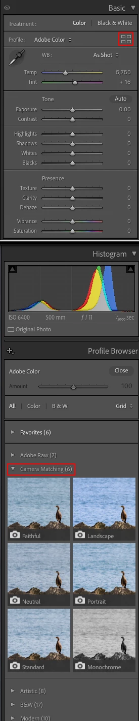

You haven't mentioned what you're comparing the raw files in LrC to. If it's the image on back of camera, then what you see is expected. The image displayed on the back of your camera is a JPEG preview that has already undergone 'in camera' processing. This processing is based on the 'Picture Style' you selected in camera. The default for the R5 being 'Standard'. Fortunately, Adobe has provided a set of profiles (Camera Matching) with similar characteristics to each of the R5 'Picture Styles', but you need to apply these as a Preset on import, changing the default settings or on an image by image basis in LrC to match your camera. I've provided a link below explaining how to change LrC's default setttings.
In meantime, you can apply the Adobe Camera Matching profiles that match the Canon Picture Systles via the 'Profiles' button as shown in attached screenshot
https://helpx.adobe.com/uk/lightroom-classic/help/raw-defaults.html
