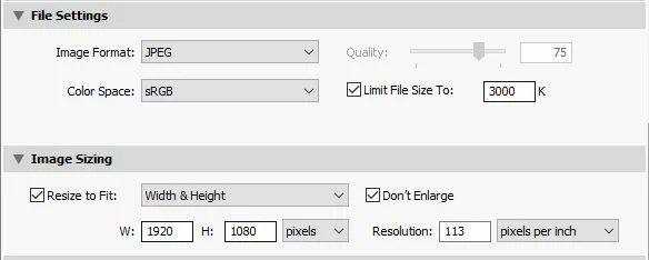

further to Conrad C's excellent answer, the concept that helped me to understand the resizing settings was:
These numbers do not directly control what your picture's resized TO. They control a "containing box", which each exported picture is then scaled down to fit INTO - and if the picture is ever squarer or skinnier shaped than this "box" is, then it can't completely fill that "box".
IOW, the resizing settings don't state what you will get. They state the upper limit on what you can get.
If you specify only one dimension, either the longer or the shorter side, then you can know this will be the governing dimension.
When you specify both width and height, then either one may become the governing dimension depending on the picture's shape vs the box's shape. Taking the simplest example of a square "box", the width of this will govern any landscape orientation photo, for a lower resulting height than the box's height. Conversely, the box's height will govern the sizing of any portrait orientation photo. And both will equally govern a square photo, which can completely fill a square "box".
If you wanted (say) to ensure that the Width was always used as the governing dimension, regardless of photo orientation - then you can set a very large value for the height. All images will in practice then hit the left and right sides of this imaginary, very tall and narrow "box" FIRST - and never approach its top and bottom limits. E.g. I could set 1800px wide x 20000px high, and always get that width, and never get that height.

I have submission requirements for one of my clubs. The photos must be
"They must be a maximum of 3 MB in size, and either: 1920 pixels wide and no more than 1080 pixels high OR 1080 pixels high and no more than 1920 pixels wide"
This is what my Export dialog box looks like. So, for example, if I export a 6881x4484 pixel photo with the above, I get a 1080x704 902KB file.
