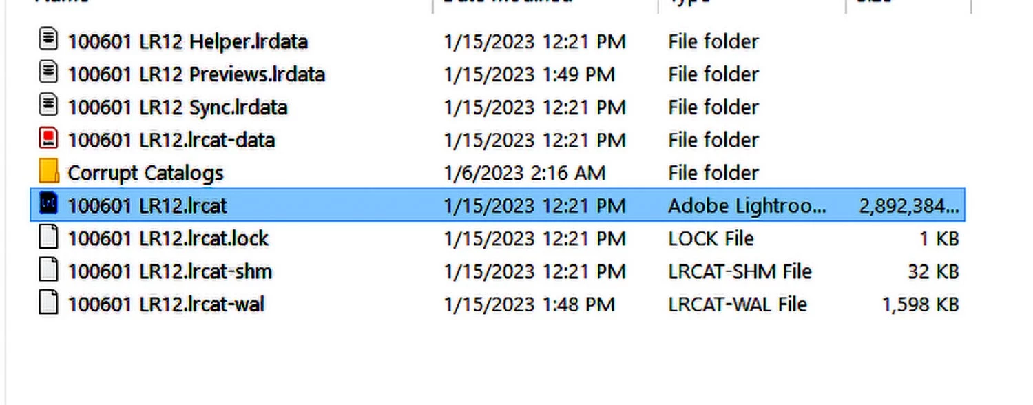

To get my keywords back I copied my last catalog back-up (the full catalog set of files, not just the zipped back-up) When I clicked on the lrcat file it said corrupted but LrC fixed it.

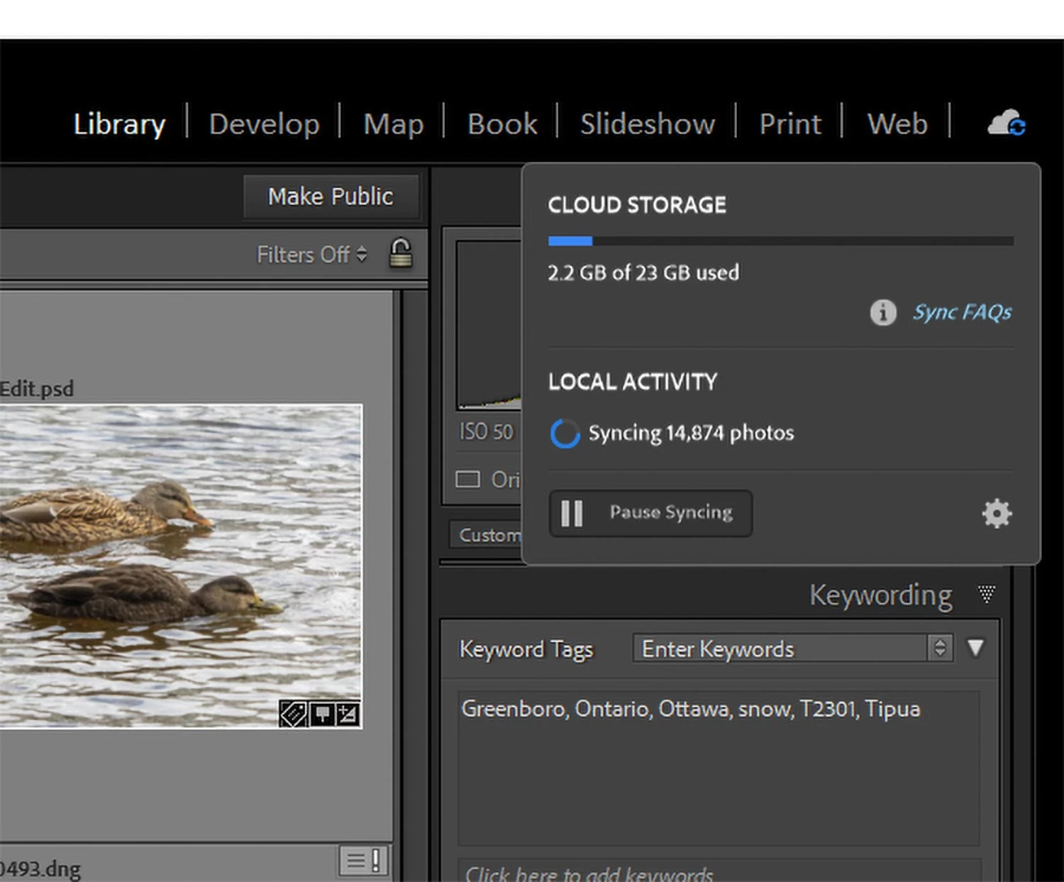

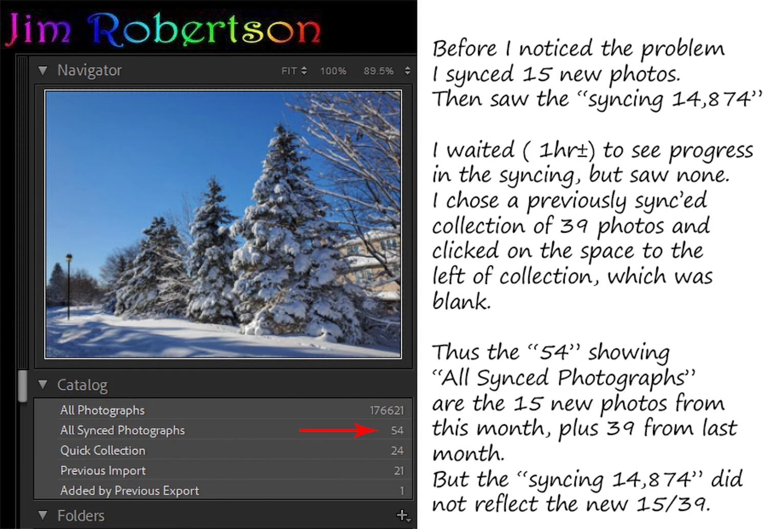

Now I have just noticed that NONE of my collections are showing as being sync’ed (The zig-zag line next to the synced collections are all gone) and the top right syncing activity dialogue box is showing 14,874 syncing.

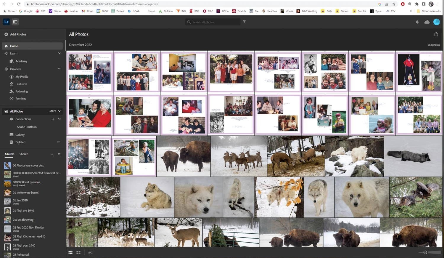

I went to step 1 (lightroom.adobe.com), no issues showed
I went to step 2, let the syncing run for 60 minutes - no change in numbers
I went to step 3, (Preferences>Lightroom sync>sync activity)nothing showed.
I have not tried changing the synch.lrdata to “old” yet.
I have some zipped catalog back-up files from late December

UPDATE Jan 19 LrC is no longer trying to sync the 14,874 files. Clicking next to a collection does not cause it to sync.
