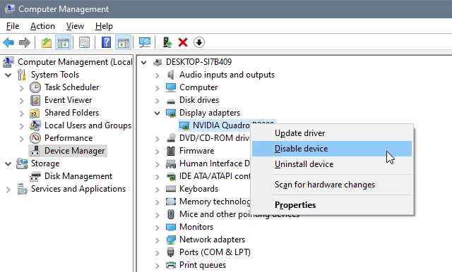

Also, if your computer has an integrated GPU, make sure that it's disabled in the Device manager.
Adobe software does not work well with multiple GPUs.
